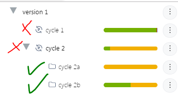

Have been successful in using the rest api to get summary of execution results:
http://localhost:2990/jira/rest/zapi/latest/cycle/cycleId/folders?projectId=&versionId=&limit=&offset=
However, the way that my organisation has organised things is to have put most of the data into cycles, without putting them into folders.
e.g.
Version 1
> cycle 1
> cycle 2
    > > folder 2a
    > > folder 2b
I can get results for folder 2a/2b etc, but not for cycle 1 as it doesn't have any sub-folders. But I can see the results in jira
I've done my best to download the data using:
http://localhost:2990/jira/rest/zapi/latest/cycle?projectId=
but it's only by downloading each and every execution and the result of it that I'm able to get this data. It'd be very good if I could get the summary for the cycle, just like I can for folders, with a roll up of pass and fail results. Is this possible? If so how?
