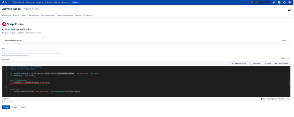

Please note that the sample working code above is not 100% exact to your environment. Hence, you will need to make the required modifications.

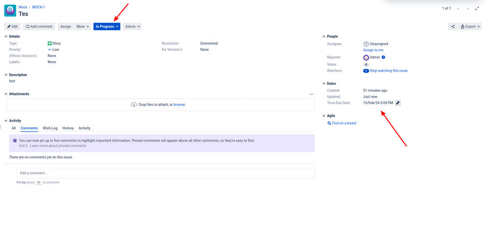

Below is a screenshot of the Post-Function configuration:-
If you observe the screenshot above, the ScriptRunner editor is complaining about a TypeScript check. You can ignore it, as the code works just fine.

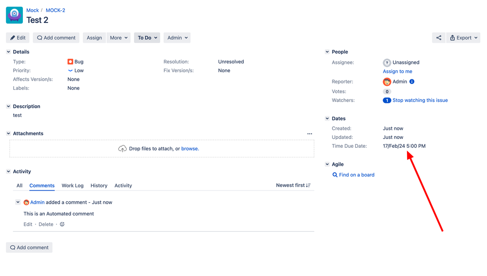

Below are a couple of test screenshots for your reference:-

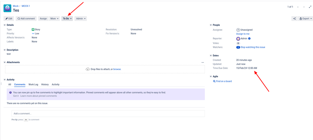

1. When the issue is first created, the date is set to 15 February 2024 00:00:00, but the format displayed in this instance is 15/Feb/24 12:00 AM.
2. Once the issue transitions to In Progress, as expected, the date time field is updated to 15 February 2024 17:00. The format displayed is 15/Feb/24 5:00 PM.

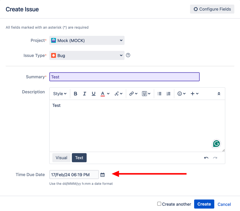

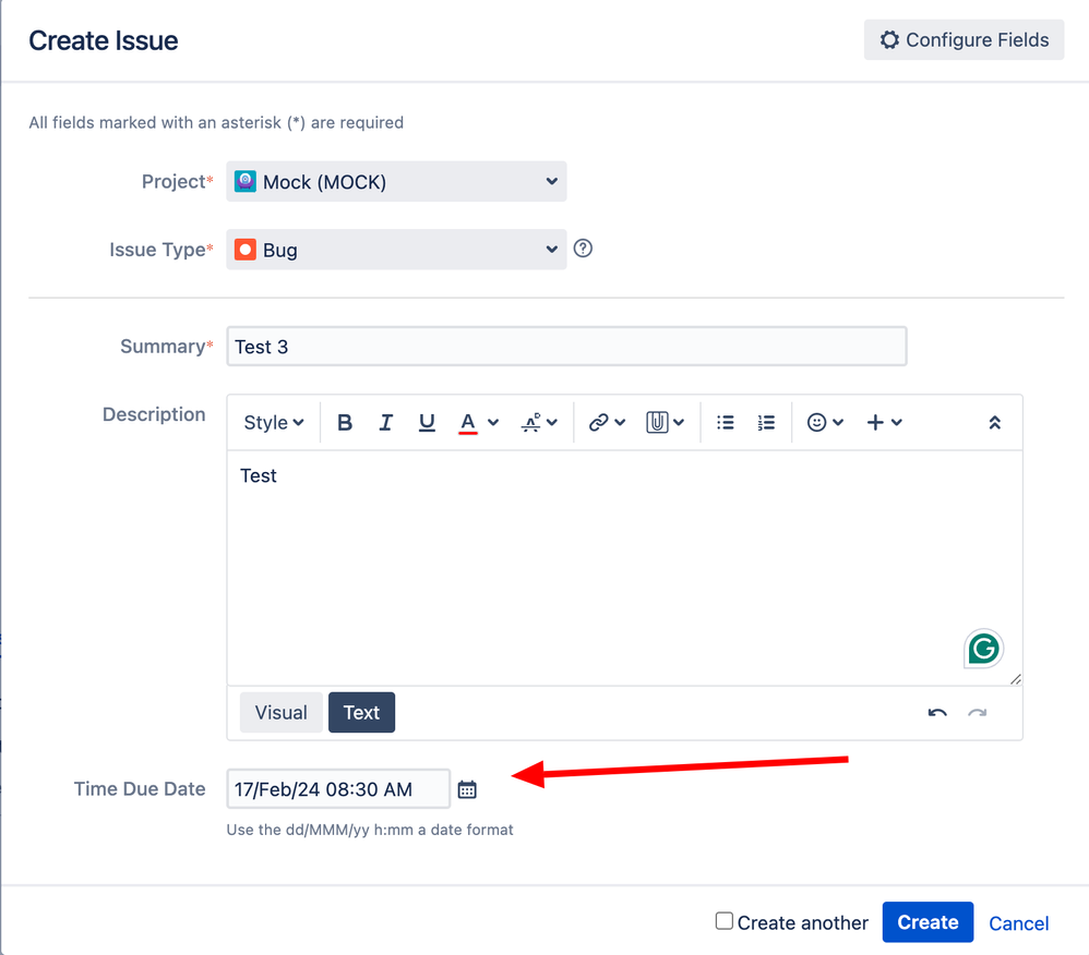

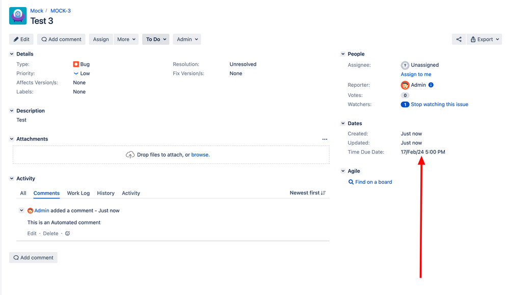

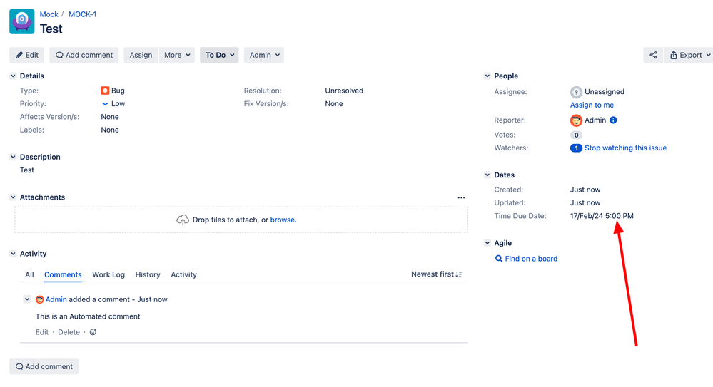

With the updated code, irrespective of the time that has been entered into the field, it will automatically reset to 17:00, i.e. 5:00pm
If you observe the screenshots below, irrespective of the time I set in the Time Due Date field, i.e. Date Time field, once the issue is created, it is automatically set to 5:00 p.m.
I hope this helps to solve your question. :-)

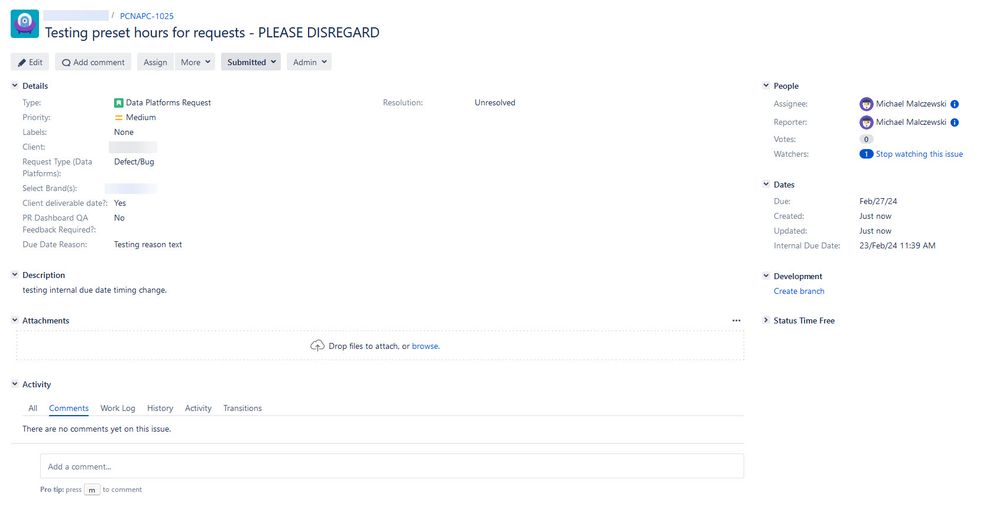

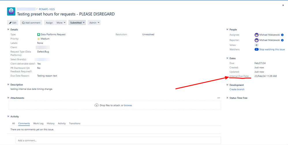

But for some reason, the post-function is not changing the time as I've seen in your screenshots:no time change.jpg
I picked the future date (2/23) and kept the time as "default" which Jira selected as the current EST time of 11:39am.
We are currently on the latest LTS 9.12 (data center) Jira version, and I'm also putting this post-function after creation of the issue.
Can you please let me know if I didn't change something within the code that I needed to?

There seems to be an error in your code. You have declared your Team Due Date field as such:
def currentDueDate = issue.getCustomFieldValue(customfield_20000 'Team Due Date') as String
You should instead declare it as:-
def currentDueDate = issue.getCustomFieldValue('Team Due Date') as String
I am aware when using the ScriptRunner Post-Function editor, it will automatically display the custom field Id along with the Field name that you have provided.
But please double-check if it has been hard coded. I'm asking this because, even though the field ID is displayed in the ScriptRunner Editor, it will not be included when you copy the code and paste it to a text file or in the comment field.
Also, from the screenshot you have shared, the field is Internal Due Date, as shown in the screenshot below:-
Please confirm if you have included the Team Due Date in your project. I am asking this because I can't see that field in the screenshot you shared above.
I can only see the Internal Due Date field. If the Team Due Date exists on the project you are testing, please confirm if you have added any value to it when testing.
It would be best to share a screenshot of your create screen.

Michael
February 21, 2024
Hi again @Ram Kumar Aravindakshan _Adaptavist_
I was only displaying the customfield ID that is shown within the editor. I did not hardcode that number into the code. (I just wanted you to see that ScriptRunner was able to find the needed customfield)
As for the name of the customfield, "Internal Due Date" is the actual name of the field and its customfield ID is the displayed "customfield_20000", I was using "team due date" as a non-existent "example" field because it was easier to type within my questions above and I wanted to stay consistent - but I realize that doesn't help troubleshoot issues. Sorry for any confusion.
