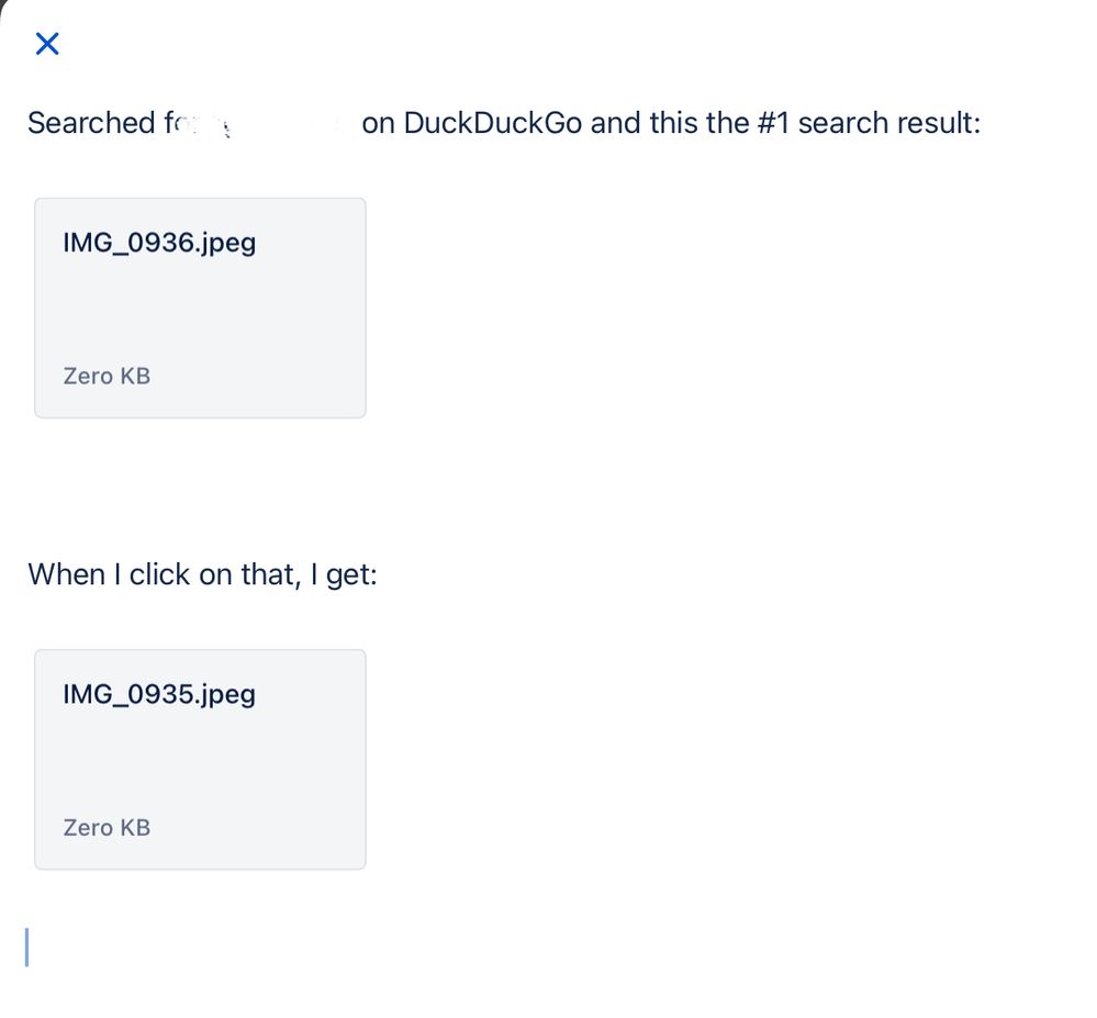

I attempted to create a bug card and upload screenshots of the bug. The screenshots I captured then cropped on my iPad Pro 11" uploaded as "zero KB" in size. Other users confirmed they are unable to see them.
I have the current version of the app as of 5/18/22. Tried deleting and reposting the card.
When I use a browser to access Jira instead of the app, it works. I can see the attachments there.

Hi Ian,
Just so that I can confirm what you are attempting to do, you are using the Jira Mobile app on your iPad and attempting to select an image stored on the iPad when the issue happens.  But when you access Jira via the browser on the iPad and pick the same image to upload it works?
I just ran a quick test on an Android device and was able to upload an image both via capturing it via the camera or picking a file.  So I am curious if there is perhaps a permission setting on your iPad that needs to be granted.

I have been trying to replicate the issue and haven't been able to so far. The fact the app can upload photos from the Camera interface implies the app is able to upload photos.  The fact the file in question can be uploaded via the browser seems to indicate that the file itself is okay.  So it seems for some reason that the mobile app is unable to access the file.  It can see it (which is why you have the option to select it) but it doesn't seem able to transmit it or pull into the mobile application.
Do you also see the preview of the image in the mobile when you try to upload it?  Or does it just show the placeholder icon and then the 0 KB size in the lower corner of the placeholder?

Can't see a preview of the image on the app on the iPad. It just shows the placeholder.
Was able to see the image when using a browser to access the Jira board, even though I can't see it on the iPad the images were uploaded from, when using the Jira app.
