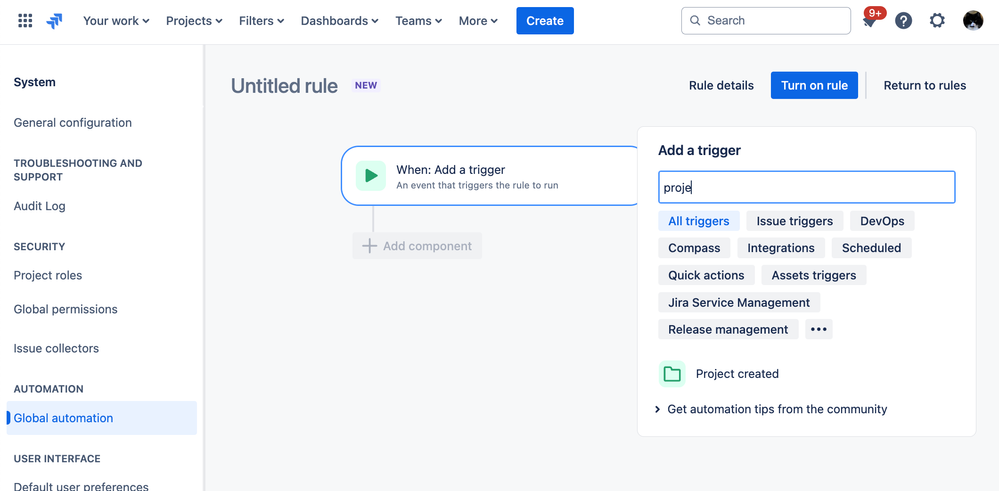

That trigger can be found only when creating a Global Automation Rule, which can be done only by Jira Administrators.
If you are trying to create an Automation Rule from the Project Settings page of a specific project, the rule can be applied only to that project. The Project Created rule, obviously, can't be created in the Project Settings for a project that does not yet exist. So it must be created as a Global Automation Rule.

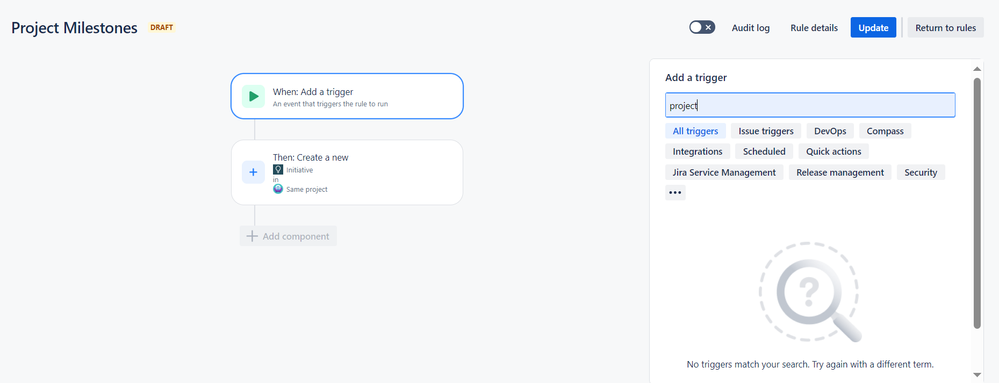

Hi,
That may be my problem then, I can create automations, i tried one earlier but it didnt fix my issue so i disabled it, but as you see here when i search 'Project' nothing shows like yours where it shows a green folder imgjira.png

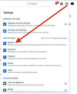

To get to the location I showed you need Jira Administrator privileges. Then you would navigate to that page thus:
If you don't have that level of access, you would need to work with a Jira Admin for your instance to get the rule created.

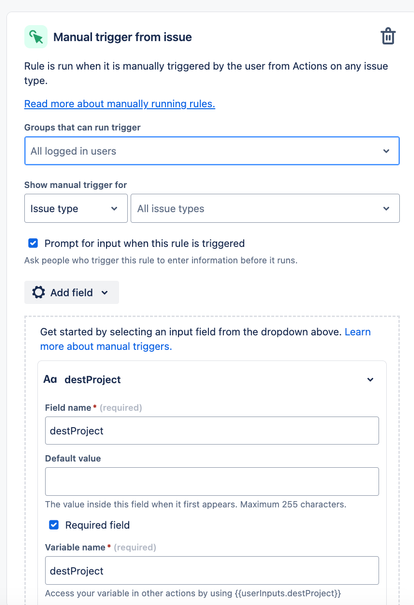

You can use the Clone Issue action to clone an issue from one project into another, without creating a Global Automation Rule. If you have a project that has a "template" set of the Initiatives you would want to copy, then you could set up a manually triggered rule in that project. In that rule you could retrieve all the Initiatives with a For Each / Related Issue / JQL branch step, and then use the Clone Issue action inside that branch to clone each issue into the new project.
With a manually triggered rule you can prompt the user for input, asking for the destination project's numeric ID to be entered.
The user would have to enter the 5 digit number that is automatically assigned to the new project. It is not the alphanumeric Key that prefixes the issue keys.

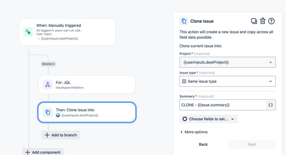

Then add a branch step to retrieve all the issues in the current/source/template project from which you triggered the rule. Make sure this box is unchecked
Then add the Clone Issue action inside the branch. You'll have to use a smart value to reference the user's input to select the destination project.
