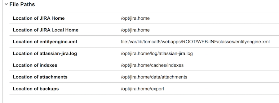

Thanks for the response. I have looked through the System Info page and I cannot find the path that would even remotely resemble an installation directory. Attached is an image of of the file paths I see on my System info:
Is there any command I could use in the  command line shell to determine the installation directory?

Steve Loo
August 6, 2018
Upon further investigation, I believe I found the installation directory, which did not stand out easily. The directory is called  atlassian-jira-6.1.6.war which is found in /opt.
Strange that I could not find this listed in the System info page.
Thanks Nic, for pointing out that I was looking at the wrong directory to begin with.

Nic Brough -Adaptavist-
August 6, 2018
Ah, hang on, you've got a .war installation.  These are not supported any more, and can't be upgraded by the installers.
You'll need to convert to a standalone 6.1.6 first, then you'll be able to upgrade it.
