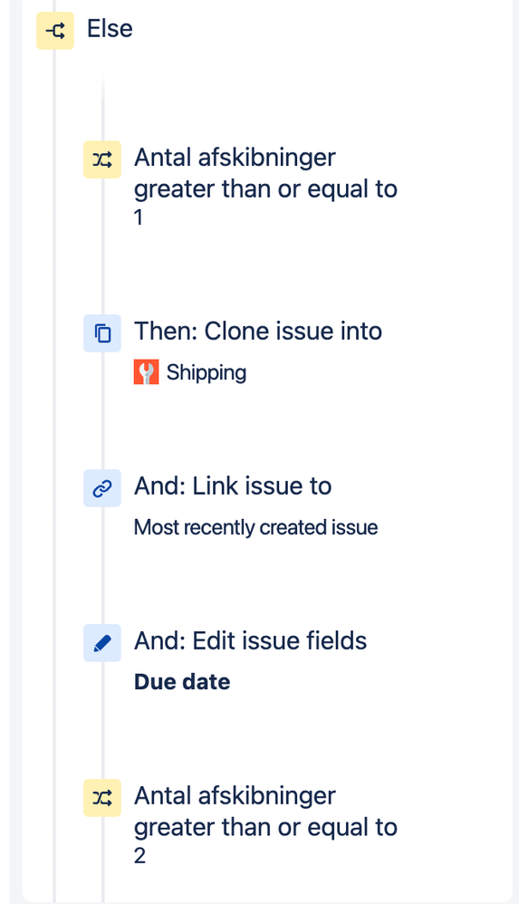

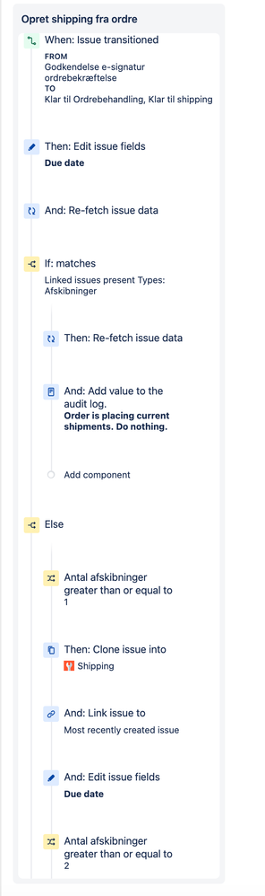

I have a Jira automation that creates a number of new tasks in a different project and links them back to the original issue. It clones the data into the new project, as shown in the partial screenshot:
This solution has 2 problems:
It only works up to 14 or so new tasks (Antal Afskibninger) before i run into the 65 component limitation,

I need the issue to be in a specific status:
issue.status="Klar til Ordrebehandling"
But i also need the links not to contain links that are "Afskibninger". Does anyone have idea how to do this?

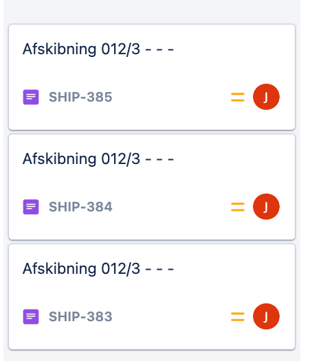

@Bill Sheboy I got the Advanced Branch idea to almost work. I have one issue that I cant figure out how to fix.
The newly cloned issues should have the names like 1/N 2/N ...n/N .. N/N
I got the N part working by using {{webResponse.body.value.size}}
But inside the smart branch i need to know current iteration number, i have been trying to use {{index}} as: {{#webResponse.body.value}}{{index}}{{/}}
But that gives me all indices in each iteration so i end up with:
 012/3
 012/3
 012/3
as output.
Naturally I would like the index to start with 1, but that's currently a minor issue compared to that I cant't get the index at all.
I can see in the forum that I'm not only one with this problem, but I can't seem to find a solution for this part.
Thanks in advance
Jens

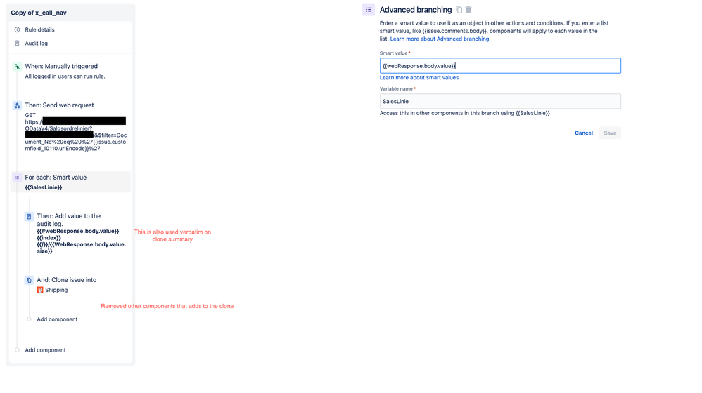

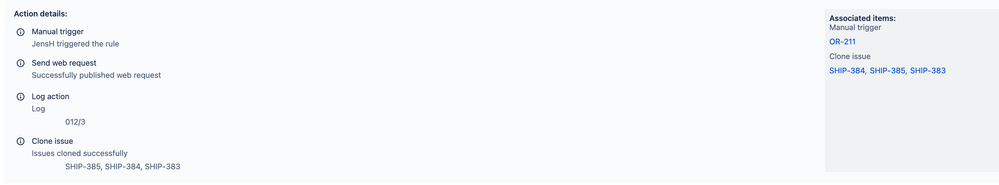

I should have added the automation, sorry, here it is, including log and generated clones.
Thanks for help.
Best
Jens
Screenshot 2023-09-16 at 18.52.55.pngScreenshot 2023-09-16 at 18.49.40.pngScreenshot 2023-09-16 at 18.52.31.png
Bill Sheboy
September 16, 2023
Does your {{SalesLinie}} information in the branch source contain your counter values that you want in the cloned issue summary?
Can you please show what you are using to set the summary in the clone issue action?
