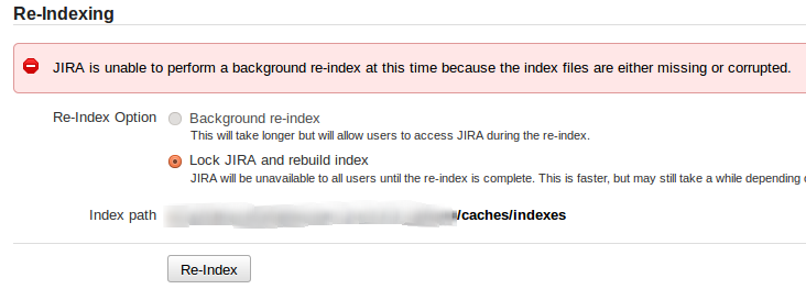

When upgrade Jira Server to v8.2.4.    Perform a full re-index can not runnning in the background.
The Background re-index radio button was disabled.
If running with「Lock JIRA and rebuild index」. JIRA Server will be unavailable to all users.
I can not lock my company's JIRA server because many people is being used.
and rebuild the full-index will be take one week.
May I Anyway to enable re-index in the background.

When I Upgrade all plugins to the latest version.
The background re-index button was enabled 。And Re-indexing was successful.
