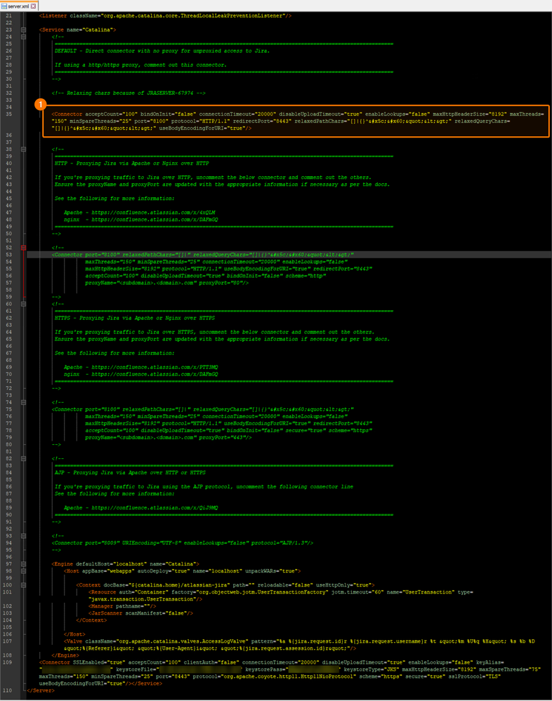

Those changes were made but still no luck in getting it to work properly. (See image)

Down at the bottom of your screenshot where you've blurred some keystore info out (line 109), you've got a second active connector (serving HTTPS). That connector is missing the required options:
relaxedPathChars="[]|" relaxedQueryChars="[]|{}^&#x5c;&#x60;&quot;&lt;&gt;"
 Should be good to go once those options are added!

Success! Thanks Daniel.
