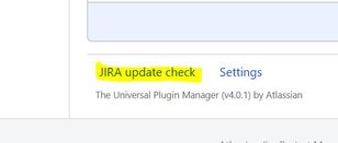

Hi @Ben Damon,
I'd recommend that before your next upgrade use this link in the bottom of the manage apps page.
It will allow you to see if the author of the add-on as made an updated version that is compatible with the version you plan to upgrade to.  I'm pretty sure what you are running into is that you have upgraded to a version ahead of the author having actually released an 8.1.0 compatible version.
Hope that helps.
-James
