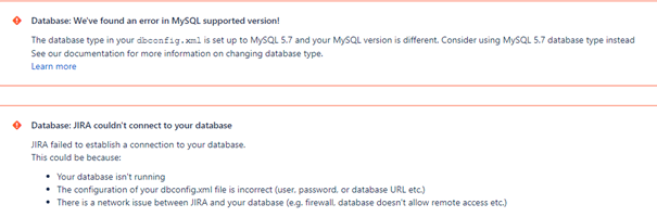

I started Jira using the start-jira.sh script and when I opened the webpage I got these errors:

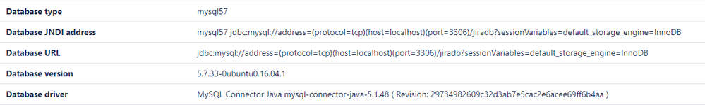

The first error seems strange to me because prior to the update I made this screenshot in Jira 8.6.1 showing the MySQL was version 5.7
But the 'learn more' suggested to change the dbconfig.xml file.

I changed the <url> tag to the line below because the error suggests that's were not using MySQL 5.7:
<url>jdbc:mysql://dbserver:3306/jiradb?useUnicode=true&characterEncoding=UTF8&sessionVariables=storage_engine=InnoDB</url>
But now I get an error that the option storage_engine is deprecated so that was not it.

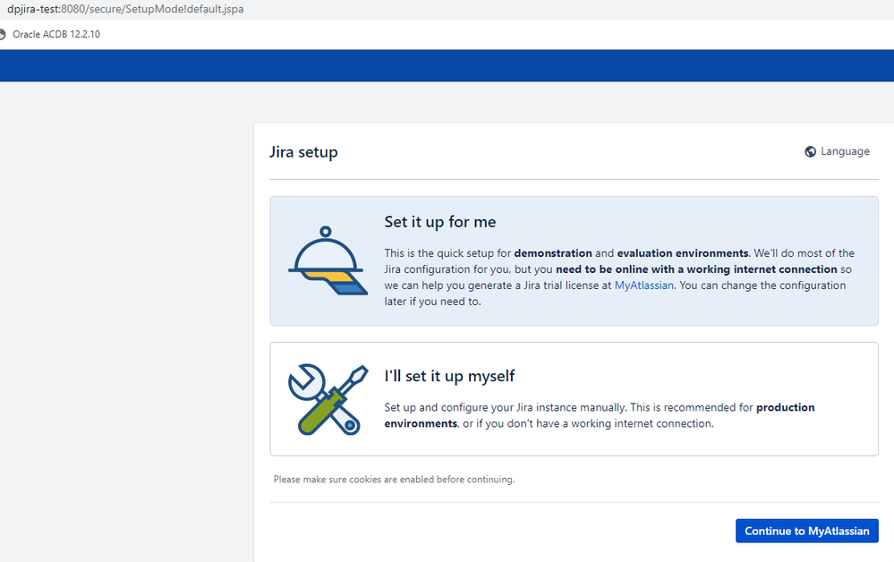

Changed the <url> to this line:
<url>jdbc:mysql://dbserver:3306/jiradb?useUnicode=true&characterEncoding=UTF8&sessionVariables=default_storage_engine=InnoDB</url>
Now at first it looked ok, Jira was starting, Atlassian Jira is ready on the webpage.
But then... I get the screen for initial setup where I have to create a database connection?
I've upgraded before from 8.3.3. to 8.6.1 and I cannot remember that I had to do that again. Also it's not mentioned anywhere in the upgrade documents.

Ok after an intensive search it found another topic and it turned out that I had to add the text below so ssl would not be used.
The config.sh test for database setup failed with some message about ssl so that got me searching in that direction.
<url>jdbc:mysql://address=(useSSL=false)(protocol=tcp)...

Jira message at startup:
The database type in your dbconfig.xml is set up to MySQL 5.7 and your MySQL version is different.
Show version = 5.7.33 and dbconfig.xml contains <database-type>mysql57</database-type> so both are 5.7.
So why this error?
