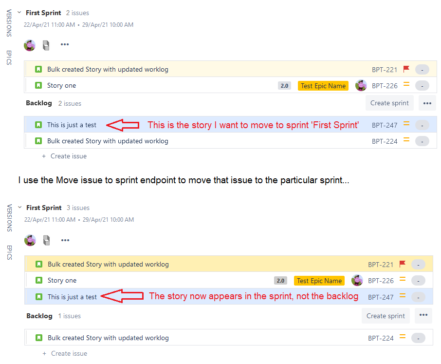

I have just run a test on Jira Cloud and cannot replicate the problem you have described.
  1. I have an issue of the type Story visible in the backlog via the GUI
  2. I use the Move issue to sprint endpoint to move that issue to a particular sprint
  3. I refresh the page of the GUI and the issue is now showing in the desired sprint, not the backlog
