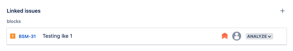

ticket in MIB have linked issue "blocks" to BSM board:

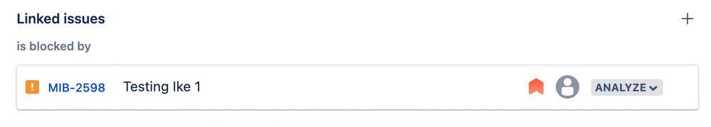

ticket in BSM have linked issue "is blocked by" to MIB board:
