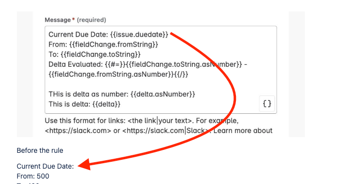

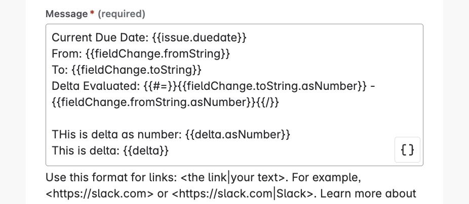

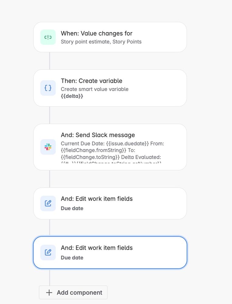

This is the rule:
and I have the following logs before and after the rule
Which prints the following:
Before the rule
Current Due Date:
From: 500
To: 100
Delta Evaluated: -400
Tgis is delta as number: -400
This is delta: -400
After the rule:
Current Due Date:
From: 500
To: 100
Thigs is delta as number: -400
This is delta: -400
I know I am changing the right field cause I am having a test set as 5 extra business dates as a test where I am just adding 5 business dates and it works. So I am at the end of my rope here.

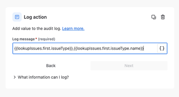

Side note: are you aware of the Log action that you can use to write information into the Log that is generated by the rule execution? This is useful for debugging rules, and you don't have to send a message to Slack or through email. It isn't good for multiple line messages, but you can add more Log actions to print each line separately.

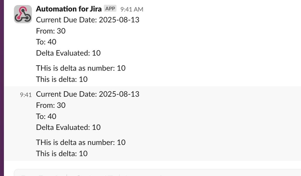

Apologies I happened to run the rule after the due date was removed from a previous failed run. This is what the debug prints before and after, I am actually referencing the field correctly.
