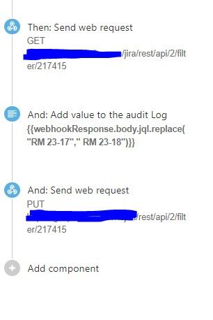

For this, I created a REST API call to first GET the JQL query of one specific filter. And then I use the PUT request to change the filter. Overall this is working but I'm struggling with replacing the specific string for my use case:
I want to use the replace function to convert the Customer Go Live (custom field) to the next release.
example JQL query from filter:
project = TRX AND issuetype = Epic AND status not in (Cancelled) AND "Customer Go Live" = "RM 23-17"
> I want to replace only "RM 23-17" with "RM 23-18" - the rest of the query should stay the same
I tested this with a log action and it works after the GET call:
{{webhookResponse.body.jql.replace("RM 23-17"," RM 23-18")}}
But it does not work like this (which is what I need):
{{webhookResponse.body.jql.replace("RM [0-9]{2}-[0-9]{2}"," RM 23-18")}}
And it the PUT call itself I could not get either to work:
"jql":"{{webhookResponse.body.jql.replace(\"RM 23-17\",\"MDDM 23-18\")}}"

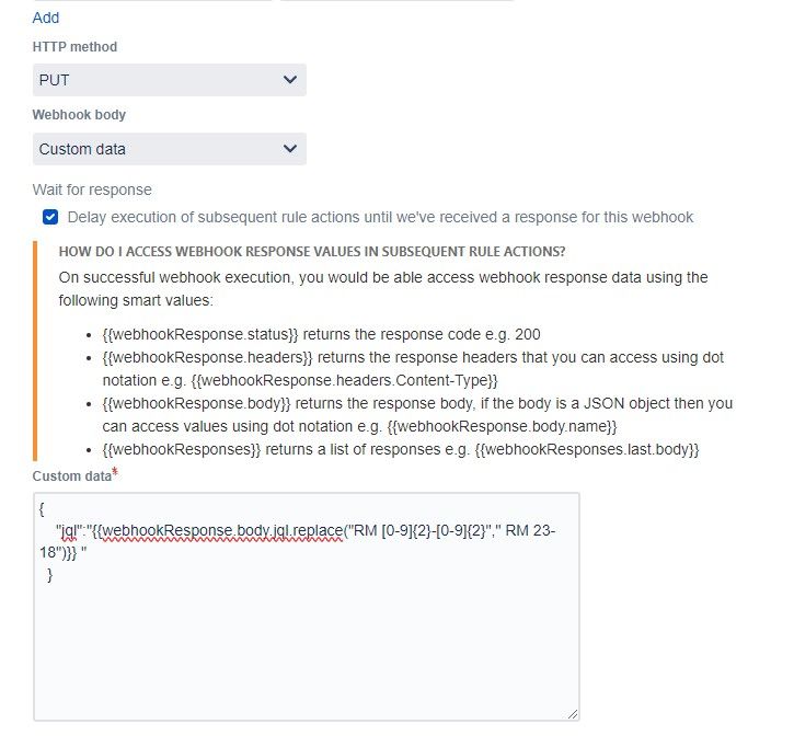

Since I'm still not sure how to dynamically change the number, I just started with using one filter and below expression to see if it works - knowing it will not be the final one.
My final vision was to use the Rest API call not only for one filter, but for around 15 filters I created. All of them have different queries and the only thing which should change is the RM-xx.
But like mentioned, the current call returns an empty filter query already. I tried adding quotes or brackets but it didn't change.
Since I only need to change the jql query and not the name or description, I did not include those two in the request:
"jql":"{{webhookResponse.body.jql.replace("RM [0-9]{2}-[0-9]{2}"," RM 23-18")}} "

Remember you need to use the replaceAll() function, and not replace() when you want to use a regular expression.
Next, your final JQL needs to have quotation marks around the string values, like this from your original question:
So we need to handle two things: the quotation marks and encoding them for sending in JSON.
The first thing we do by escaping the quotation marks when you do the replaceAll():
{{webhookResponse.body.jql.replaceAll("RM [0-9]{2}-[0-9]{2}", "\"RM 23-18\"")}}
Next we need to encode that so it works for JSON with jsonEncode.  So the final custom data would be this:
"jql":"{{webhookResponse.body.jql.replaceAll("RM [0-9]{2}-[0-9]{2}", "\"RM 23-18\"").jsonEncode}}"
Please look here for more information about the additional functions I suggested: https://confluence.atlassian.com/automation/jira-smart-values-text-fields-993924863.html
