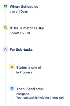

So, if I correctly understand the requirements:
  • IF parent issue not updated in last 7 days
  • AND subtask status = IN PROCESS
  • THEN send a notification to... the subtask assignee?
With these assumptions:
  • Only one subtask will ever been IN PROCESS at a time.
  • If there are more than one subtasks IN PROCESS, then the assignee for each of those will receive a notification.
If that's the case, then I think something like this should work: Screen Shot 2021-01-23 at 3.44.08 PM.png

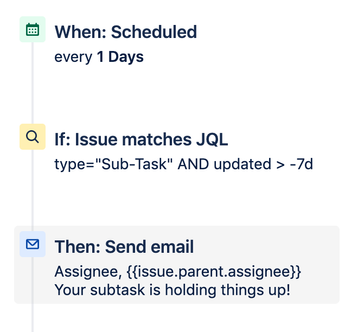

Now, I'm a little concerned that checking the Epic for updates may not be what you want.
Because are you really wanting to know whether any Sub-tasks have been sitting IN PROCESS for > 7 days? It's important to consider that even if somebody updates/closes their sub-task, it will not update the parent Epic. So even if people are hustling working on sub-tasks (all within 7 days), if nobody has changed the Epic in 7 days, a notification will still go out.
So then to simplify things, you could just look for any subtasks that were IN PROCESS and not updated in the last 7 days.
Also, did you want to notify the Epic assignee of the delay? You could do that, by adding {{issue.parent.assignee}} to the recipients.

That simpler rule would look like this:
Like • Daniel Ebers likes this
