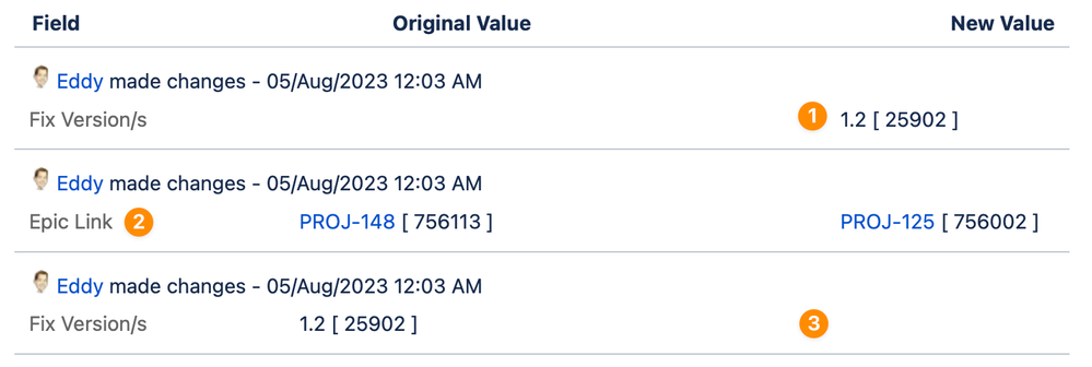

When a user goes into Edit mode and they update the Epic Link field and save their changes, the listener gets triggered, it updates the issue, but then Jira overwrites the changes the listener made back to the values they were when the user was editing the issue.
This is apparent when you look at the History for the issue:
❶ The Listener triggers first, and properly updates Fix Version/s from "none" to "1.2".
❷ Jira updates the issue and records the change to the Epic Link field
❸ Fix Version/s is reverted back to "none" 😞

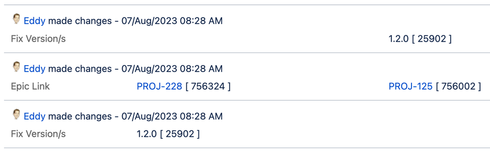

For completeness, I used the Edit button to change the Epic Link field in PROJ-153, and then clicked the Update button.
The History was updated with these three entries:

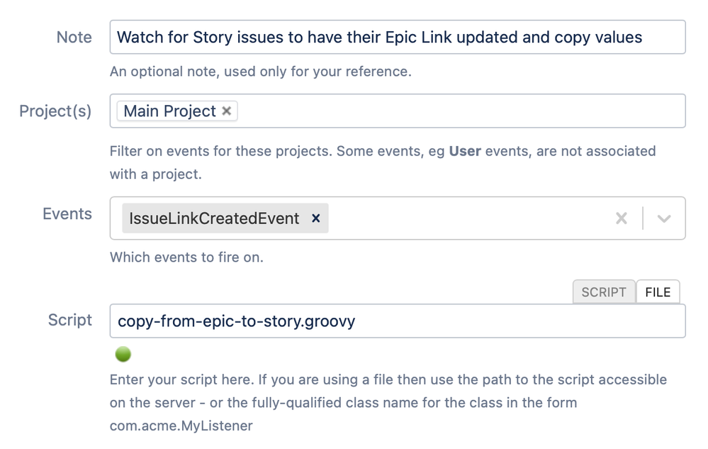

Here's how the Listener is configured:

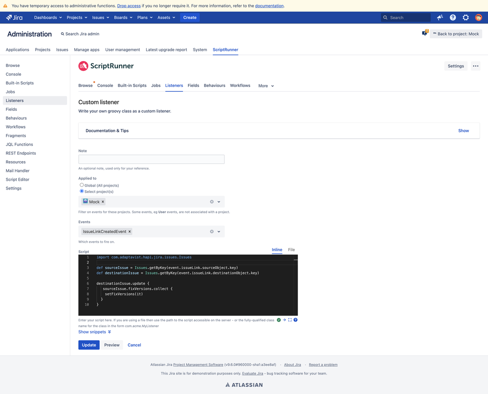

I have reviewed your code and tried replicating the problem in my environment. But I don't seem to be facing the issue.
I have run the test with ScriptRunner's HAPI feature, which works fine.
Please upgrade your ScriptRunner plugin to the latest release, i.e. 8.8.1, so you can use the HAPI feature.
Below is the sample working code that I have tested with:-
import com.adaptavist.hapi.jira.issues.Issues
def sourceIssue = Issues.getByKey(event.issueLink.sourceObject.key)
def destinationIssue = Issues.getByKey(event.issueLink.destinationObject.key)
destinationIssue.update {
sourceIssue.fixVersions.collect {
setFixVersions(it)
Please note that the sample code above is not 100% exact to your environment. Hence, you will need to make the required modifications.
Below is a screenshot of the Listener configuration:-
I hope this helps to solve your question. :-)
