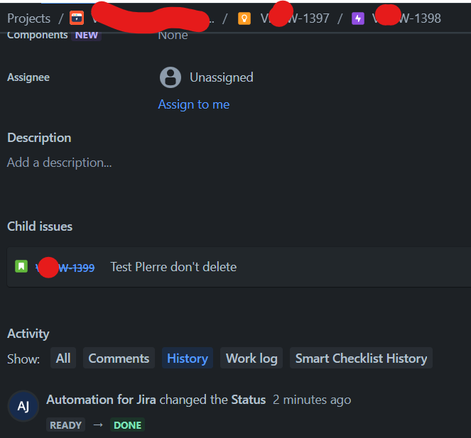

Screenshots :
Story : I changed the status
Epic : Automation is ok
Objective : hasn't changed
Again if I do the manual transition on the Epic, the Objective will change.

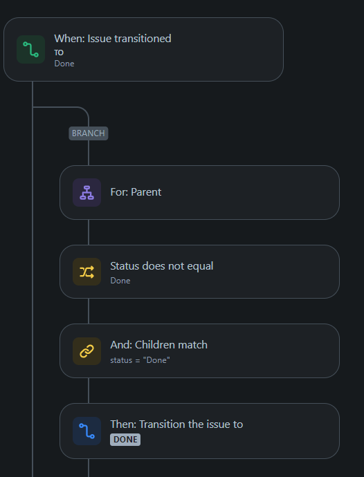

Here is my automation, quite simple for now, but I'm ok to add more steps if needed, to chain actions and automations

Hi Pierre,
I would copy the rule that you have and make it just for Epics by adding a Condition as the first step after the trigger. Condition for issuetype = Epic.
Be sure to check the box on the Rule Details page for "Check to all other rule actions to trigger this rule."
Then you probably want to change the first rule to add a Condition where issuetype != Epic.

Thank you, it works fine, I completely forgot about the box you mentioned.
I would have prefered to do it all at once, but hey, it works ! ;)

Hi @Pierre Arizolli
Just to confirm...
As written the rule should work for the hierarchy by enabling "Allow Rule Trigger", looping to trigger itself...with no need for an additional rule.  Is that what you ended up doing?
If so, please note if there are many levels in the hierarchy, a single rule approach could fail due to automation looping limits: https://support.atlassian.com/cloud-automation/docs/automation-service-limits/

Hi Bill, indeed, just checking the box of my automation has solved the problem, it was so simple that I feel a bit ashamed of not knowing that after all these years.
