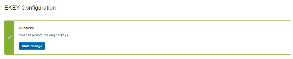

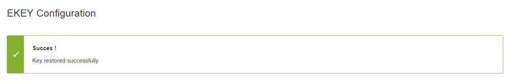

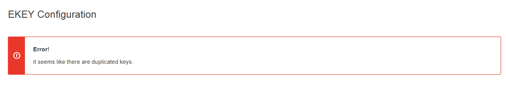

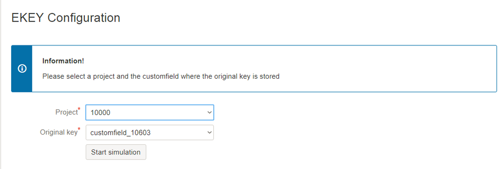

Walid Djama December 7, 2018
Hi,
Sorry for the long time.
just to know, i developed a plugin to restore the original keys of the issues by using the method "setNumber" which is in the library "com.atlassian.jira.issue.MutableIssue".
In the first time i saved the original keys into a custom field before importing issues in archive server.
there is some screenshot:
I remain available for more information.
Regards.
