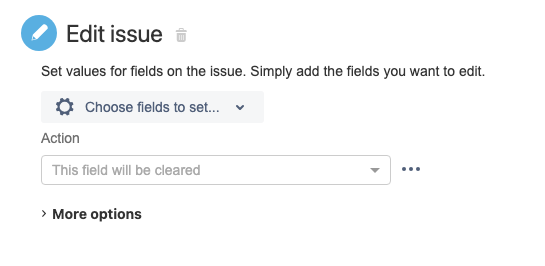

Can't you just do something like the below to clear a value from a single select custom field?

Thanks for the response @Claire Berry but unfortunately I'm having to used the advanced section due to my custom field not even appearing in that list to choose from in the first place. From what I can tell, because it is a required field, it cannot be reverted as it is expecting either value available (Yes / No). It's default is 'None' because it hasn't been selected as a required value yet. This only get's forced on the user when transitioning or amending something else on the ticket. This required field was added after the fact on existing tickets.

I am not sure why the field doesn't show in the drop down for you, that's strange. I can find fields in project automation to clear which are set as required. And I have tested the removal of this as per my screenshot previously and it works.
