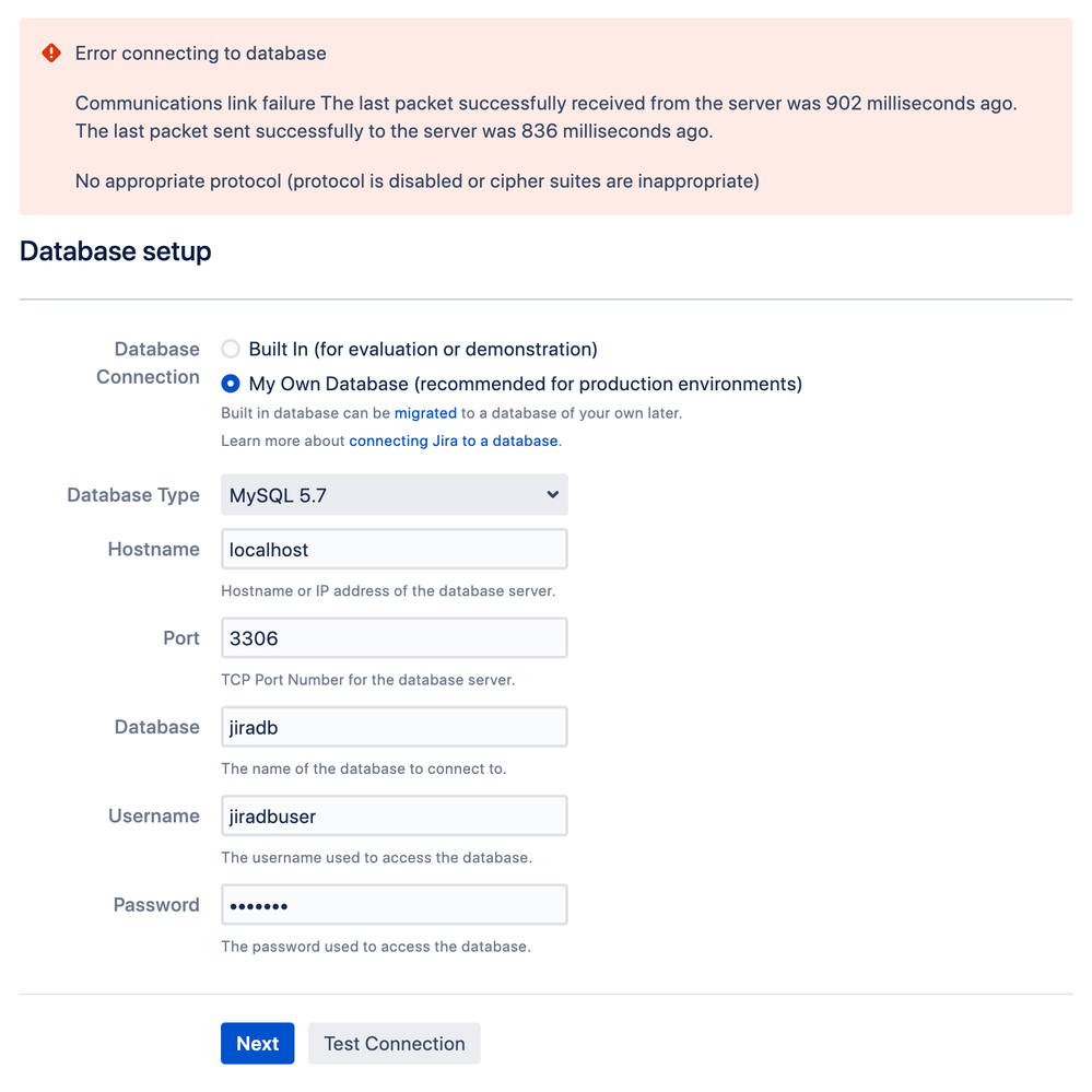

I tried to delete the dbconfig.xml and start the connection and re-configuration process again, on the JIRA startup interface. But when i type in the logon and connection credentials i and click to "test connection", i got the error message:
"No appropriate protocol (protocol is disabled or cipher suites are inappropriate)"
