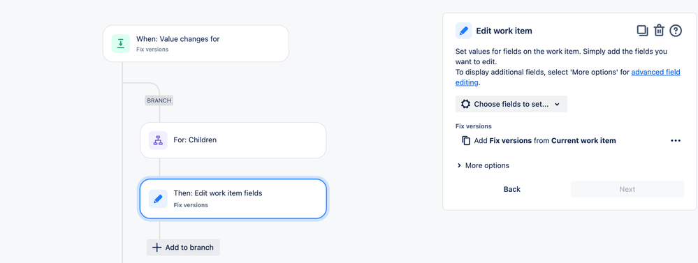

Switch to Automation instead of ScriptRunner in this case.
You can simply do the following:
Trigger = "Value changed" on edit (Fix Version)
Branch rule: on all children
Edit work-item: Fix-Version Copy from current work-item.
