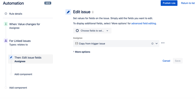

Hi there,
You can indeed implement such a thing using an Automation rule.
The following picture shows you an automation copying the "assignee" field of an issue to all the issues linked by the "relates to" link, which you will be able to adapt to your scenario.
In the example I provide you, the action is automatically triggered each time the "Assignee" field is modified (including creation).
Let me know if it helped,
Guilhem

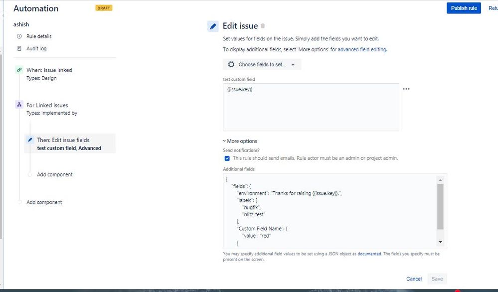

@John Funk  :
I have created the automation rule
Found the lik is implemented by .
Now i want to update the issues in " implemented by " to the text custom field which is created .
How can i do that ?

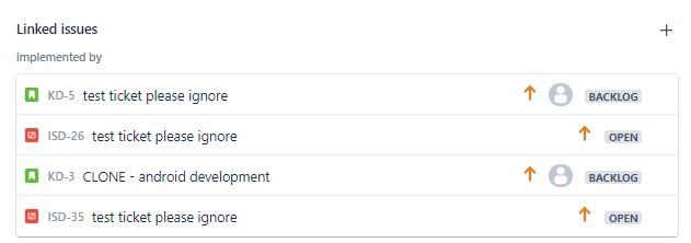

Ashish
December 17, 2020

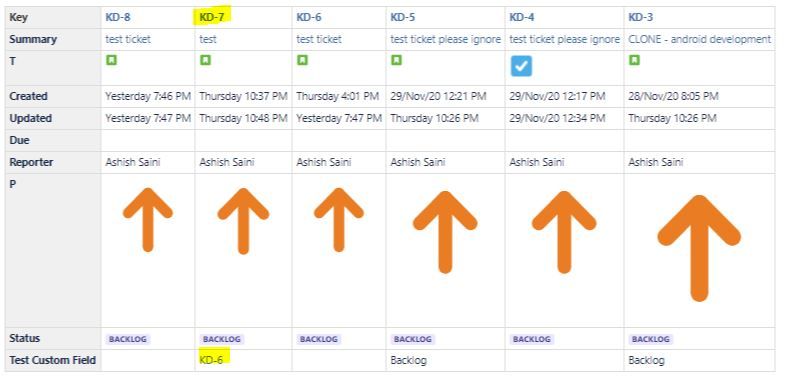

@John Funk  it dodnt work for me

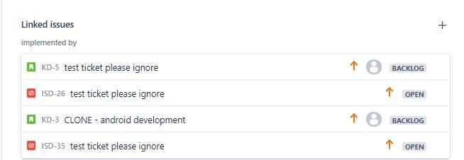

i want to update my "test custom field" with the issue key of issues linked under " implemnedted by "
KID-5, ISD-26, KD-3, ISD-35
How can i do that ?

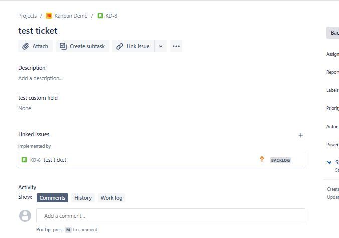

Ashish
December 18, 2020
@Bill Sheboy @John Funk

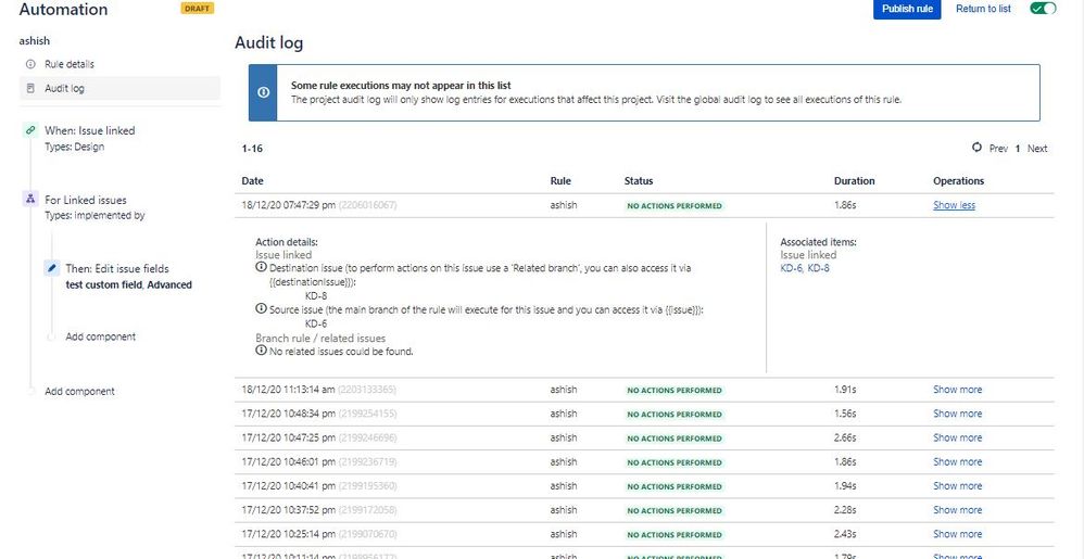

This is the audit log
I basicaly wanted to update my est custom field with issues keys of issues linked by "implemenetd by "
KD-8 has a linked issue KD-6 , but the custom field is not updated by the issues key KD-6
What is missing in this ?
Can you please advice.
Bill Sheboy
December 18, 2020
Thanks for the additional information @Ashish
It appears that the edit is trying to change the linked issues from the branch, rather than the original triggering issue, and so that may be doing something different than you needed.
Before I suggest an alternative... Please describe the problem you are solving by putting the keys to these links in a custom field?  Doing so may reveal another way to solve the problem than the rule you are asking about.
And, links are by nature changeable and so you would need to replace/update the custom field *every time* a link changes to be accurate, not just with your trigger condition.

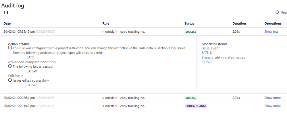

When an issue is moved from one status to another, a linked issue Gantt End to End should edit - specifically custom field Tracking no. Everything goes well and the log says done and edited. But...the field doesn't change even after days..

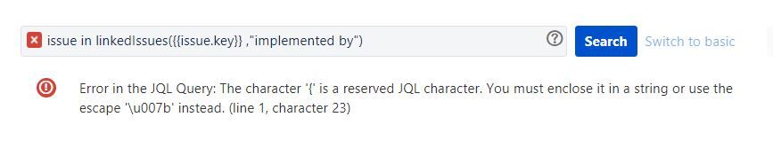

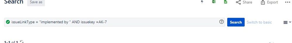

Bill Sheboy
December 30, 2020
Hi @Ashish

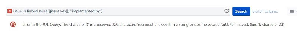

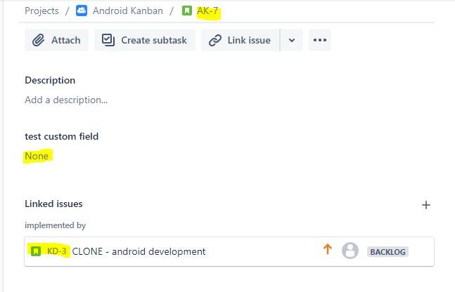

The smart value syntax such as {{issue.key}} is used within the automation rule, and not in a stand-alone, issue query.  That is why you are seeing that specific error when running  the query separately.
Please try this as to confirm it works as a stand-alone filter search:
issue IN linkedIssues(AK-7, "implemented by")
If it does not work, I suggest that you pause and directly contact Atlassian support for assistance as there appears to be another issue: https://support.atlassian.com/contact/#/
If it does work, then try this in your automation rule for the lookup issues:
issue IN linkedIssues({{issue.key}}, "implemented by")
That should return the same issues for use in the lookup.
If it does not work, I am confused how to help further and I suggest contacting Atlassian support.
Best regards,
Bill

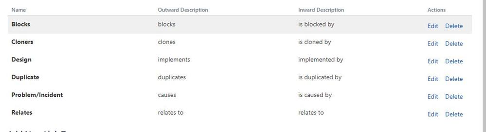

Is your link type "Implemented By" a custom link type you added or perhaps a renamed one?  I do not see that one in my default values.
If so, you may need to branch on all link types, and then add an advanced compare condition to check the smart value if the link type manually rather from the list.
It is odd that all defined link types are not listed in the branch options.
Best regards,
Bill
Ashish
December 16, 2020
@Bill Sheboy : Thanks for the response.
I got the link " implemneted by " now ..deleted and added it back.
I want to copy which are linked by "implemented by " to the text custom field .
How can i do that ?
There can be mulltiple issue under " implemented by " which i need to update in custom field.

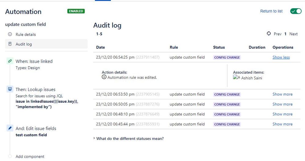

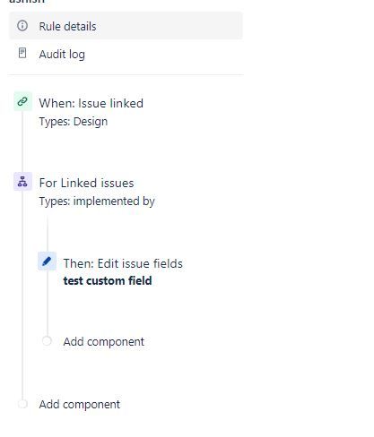

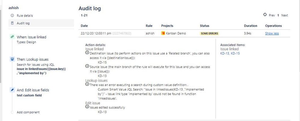

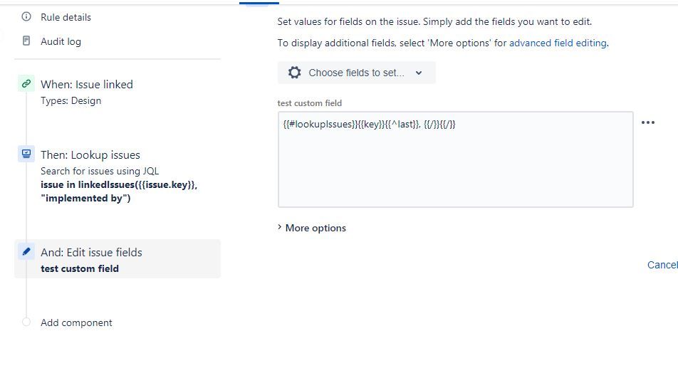

Thanks for that information.  I believe your rule may be trying to update the incorrect issues, which is why the audit log indicates what you see.  And, you are trying to update a field repeatedly (in a branch) and so replacing the results.
How about this instead: use Lookup Issues to populate the custom field?
  • Trigger: An issue is linked with type of "Design"
  • Action: Lookup Issues using this JQL with advanced JQL
issue IN linkedIssues({{issue.key}}, "Implemented By")
  • Action: Edit the custom field with a list of the keys and list functions:
{{#lookupIssues}}{{key}}{{^last}}, {{/}}{{/}}

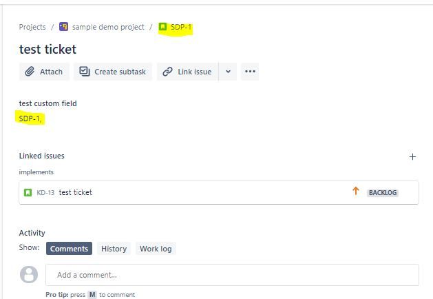

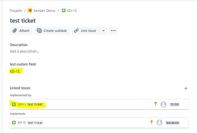

Ashish
December 21, 2020
Ashish
December 21, 2020
@Bill Sheboy  : This is audit log
Ashish
December 21, 2020

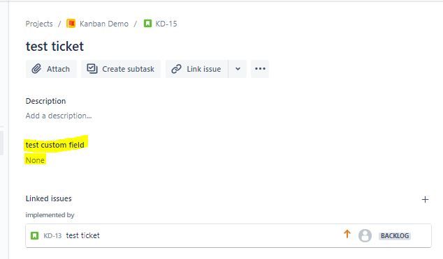

whats happening is i created origial issues KD-15 and linked KD-13
it didnt not updated KD-15 with custom field values of  implemented by
Rather it updated KD-13 with custom field values KD-13
I assocoated SDP-1 with KD-13 and it updated SDP-1 Capture.JPGCapture 1.JPGCapture 2 .JPG
KD-15 is my original issue, in which i want to update values of liked issues "implemented by "
Bill Sheboy
December 22, 2020
Hi...  I am catching up with your messages...
  • It appears you discovered that you missed one right-curly brace, and fixed that, in the Lookup Issues
  • It appears that "implemented by" does not match the name of the link type.  Please check that.
To help provide context for what is happening, please post images of:
  • your current rule and
  • recent audit log for an attempt to fill the custom field.
Thank you!

Ashish
December 23, 2020
my automation rule
Ashish
December 23, 2020
didnt update the text custom field with issuekey linked "implemeneted by "Capture.JPG

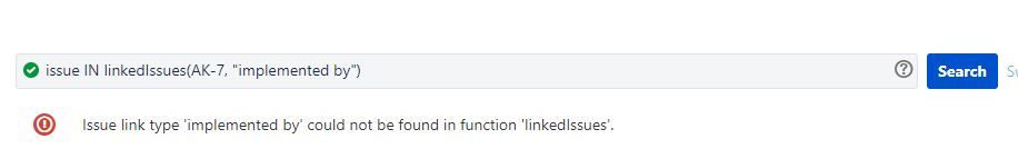

December 23, 2020
Thanks, Ashish.
The audit log image you included does not show the rule execution.  Please add that image also.

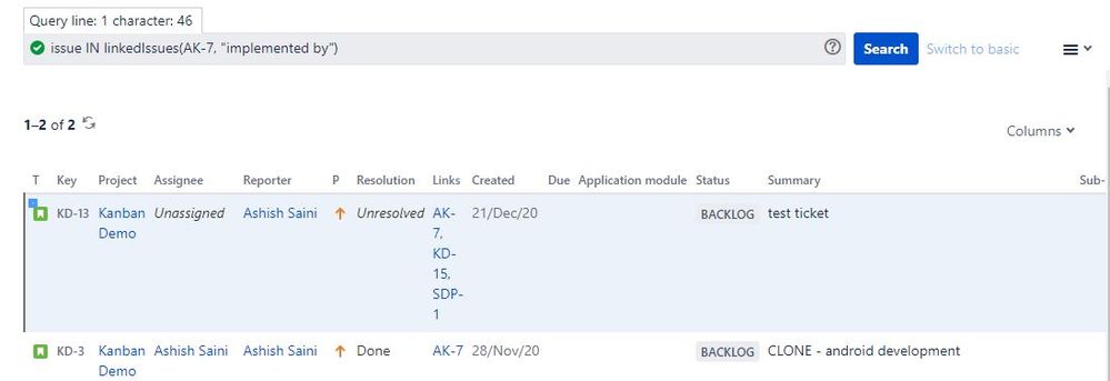

Next, please run this query in issues and filters to see the results:
issue IN linkedIssues(AK-7, "Implemented By")
Thanks,
Bill

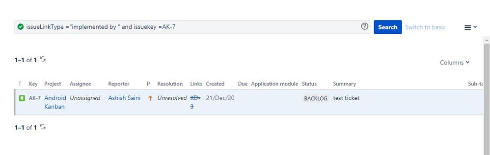

Bill Sheboy
December 28, 2020
I believe the links are case-sensitive.  Please try the exact spelling and capitalization of your link to learn what that returns.

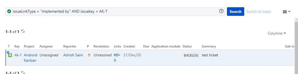

Ashish
December 29, 2020
@Bill Sheboy First of all ..Merry Xmas and happy new year.
Does this help ?
Bill Sheboy
December 29, 2020
Hi @Ashish   Happy holidays to you as well!
Did you notice that your link has a trailing space in "implemented by " when it works with JQL and does not have the space in your other attempt.  Please check to see if there is a space in the actual name of the link as that could be why it doesn't return anything in the rule.
Ashish
December 16, 2020
@Guilhem Dupuy :
There is no option available for selection linked by "implemented by " in the drip down.
I want to update the linked issue " Implemented by" value to the custom field automatically.
