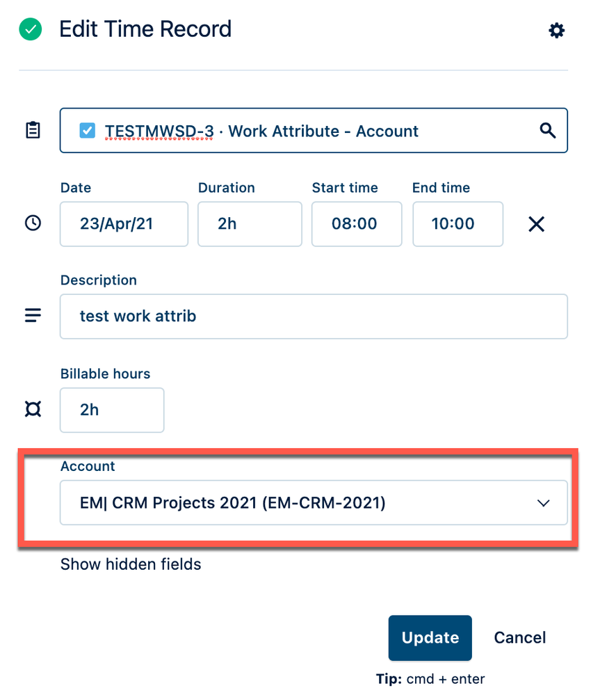

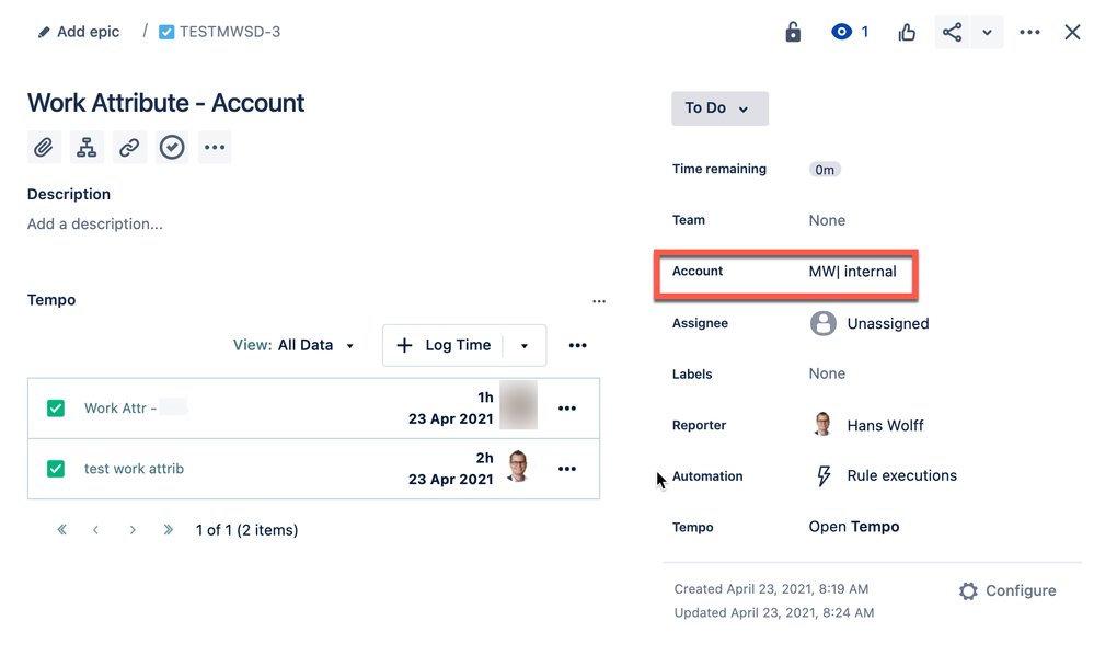

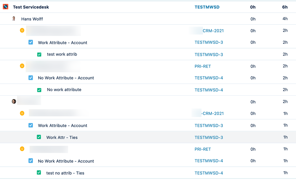

I have tried both of your scenario's ;
I created a Issue - Work Attribute - Account
Put Account to CRM;
Then employees work logs;
See below
Then I found out that this issue is a Internal issue and all worklogs should be non-bill.
So I changed the Account from CRM - to INTERNAL
But all worklogs are still on CRM?
I just want to have all worklogs changed to non-bill.
In my example there are 2 worklogs - but on a project it could be 10+
