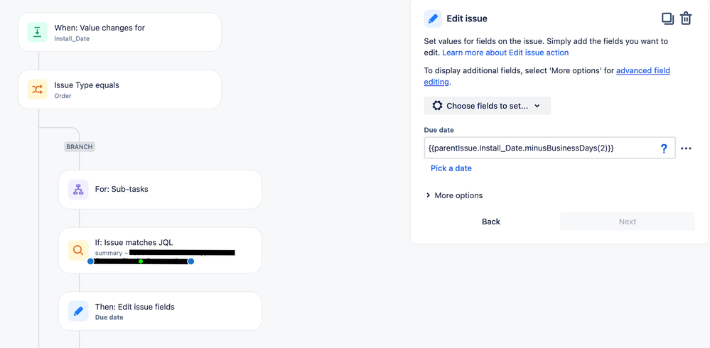

I've been trying to create a rule that does the following:
whenever the field of a task is changed, then update a specific field in a specific set of subtasks.
Here's what I created:
I also tried: {{issue.Install_Date.minusBusinessDays(2)}} but it isn't working
The rule works, and it runs, but it doesn't update the field in the subtask. I tried replacing the due date smart value for a specific date by clicking on 'pick a date' and it works, so I assume the problem is with the smart value I wrote.
For context, due date is on the subtask and install date is on the task (parent) aka 'order'
Any help is appreciated, thanks in advance!!

There are a few things to check / adjust in your rule:
What is the field type for "Install_Date"?  Is it a date picker field, or something else?
Have you confirmed that is the correct smart value for the field, Install_Date?
Smart values are name, spacing, and case-sensitive.  And often the smart value does not match the displayed field name on the issue views.  The steps below help to identify the correct smart value (and custom field id) for supported fields for automation rules.
The essential steps are:
  • identify an issue which has your field(s)
  • call a REST API function with a browser to search for your issue:
https://<yourinstanceurl>/rest/api/2/issue/<issuekey>?expand=names
  • search on the page for your field, such as with CTRL-F
    • if you find the field, you will also find the smart value, custom field id, and structure / attributes it has
    • if you do not find the field, it may not be supported by automation rules
Finally, and assuming the field type is date picker and the smart value is correct...
In the edit, you want the source to be the parent (trigger issue), correct?  If so, please change that edit action to use:
{{triggerIssue.Install_Date.minusBusinessDays(2)}}
If the name and type of Install_Date are different, please adjust this accordingly.

Martina
February 17, 2024
Thank you so much Bill!
To your question, yes, Install_Date was a date picker and so was due date. Also, I was using the correct capital and non-capital letters.
I changed the smart value condition for the edit action to:
{{triggerIssue.Install_Date.minusBusinessDays(5)}}
and it worked!! thank you so much!
