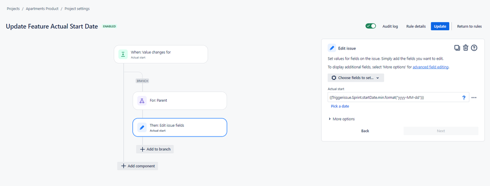

I'm trying to update the parent actual start date to the earliest value of the sprints of the child stories.  Changing the status on the children do not seem to be triggering anything.
Bill Sheboy
March 22, 2024
Hi @Brian Gauthier
Do you mean the rule is not triggering or that the value is not updating as expected?
If it is not updating as expected...
Smart values are name, spacing, and case-sensitive.  When an unknown / incorrect smart value is used, it becomes null and often fails silently (depending upon the rule structure).
The smart value for the trigger issue is:
{{triggerIssue}}
Perhaps try changing your rule to use that in the edit issue action.

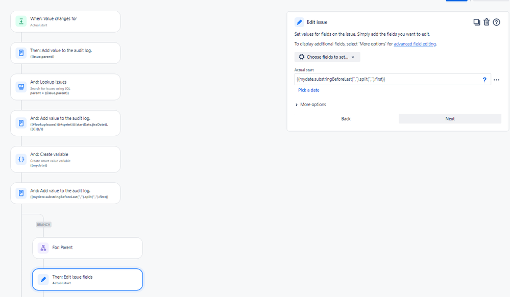

Hello @Brian Gauthier
If what I have gathered from requirement, below are my suggestions:
After your trigger = Value changes for "Actual start", you then need to find all issues of the parent like below:
- lookupIssues with JQL = parent = {{issue.parent}}
Then below smart value will give you a list of all Sprint start dates:
{{#lookupIssues}}{{#sprint}}{{startDate.jiraDate}}, {{/}}{{/}}
You then have to create a variable (mydate) andy you assign above smart value.
This variable is a string and it has trailing comma, so we can remove this trailing value and split it and find the "first" date in the list like below..
{{mydate.substringBeforeLast(",").split(",").first}}
Then, you do your branch on your Parent like you have and assign the date to your field.
Please see below for screenshot, let me know if questions..

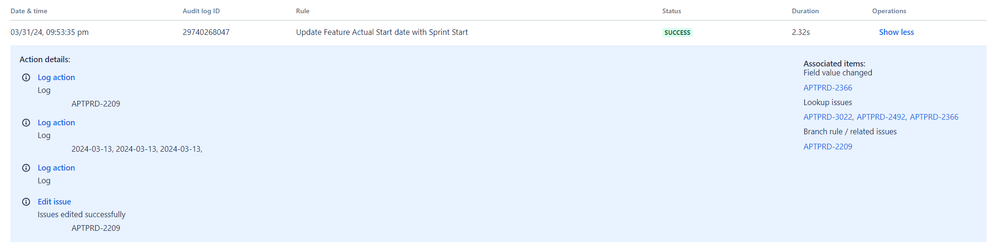

I tried updating it with your recommendation and I see the rule was successful, but the actual date did not update it with any value.   Based on the audits -- I can see dates were logged, but something went wrong.  Perhaps it was the custom variable.  jira_audit logs.png

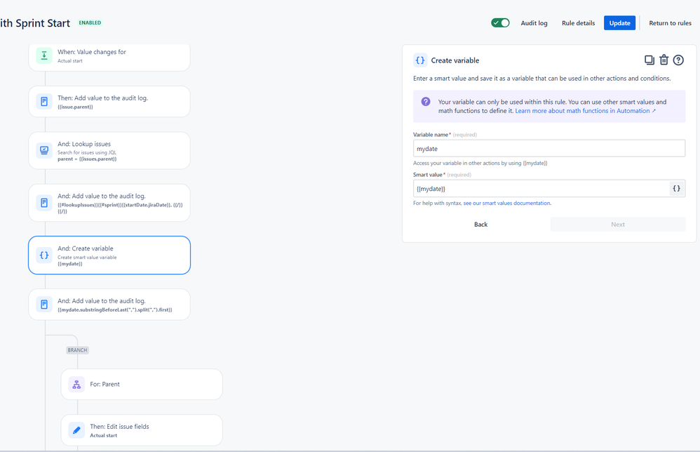

Kalyan Sattaluri
April 1, 2024
Your variable mydate should be asigned the below value :
please see screenshot:
Brian Gauthier
April 1, 2024
Got it -- so that part worked, but because the function was looking at the first date vs. the minimum date, it didn't populate the correct date.   I updated it to refer to the min, but nothing populated the value.   I know that not every child under the parent has an actual start date, so maybe that's it?
{{mydate.substringBeforeLast(",").split(",").min}}
Kalyan Sattaluri
April 1, 2024
Please use below smart value instead for min:
{{mydate.substringBeforeLast(",").split(",").toDate.min}}
