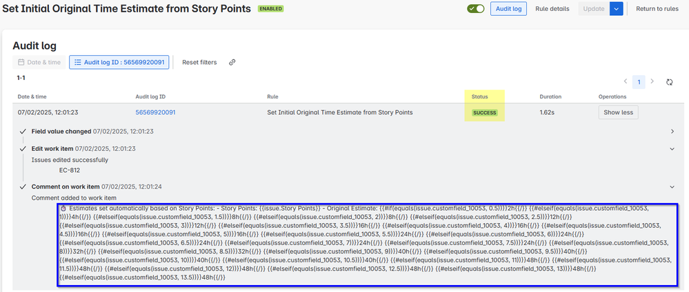

Hello All. Our org just adopted Jira and since we work exclusively off Story Points, we want to convert it into time-based estimates (using smart values as they are cleaner). I can try the whole bunch of IF-ELSE components but am wondering what is wrong with the smart values when the Audit log records a "success".

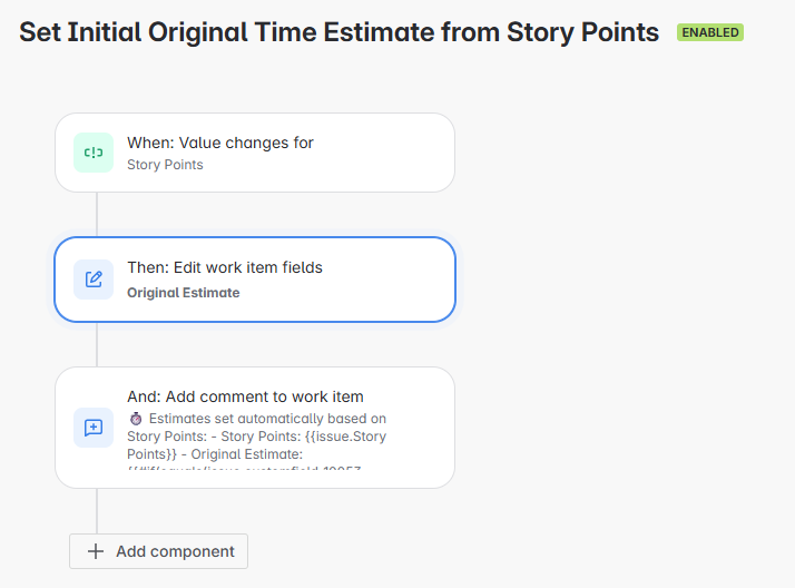

The rule is set to run when the Story Points value changes.

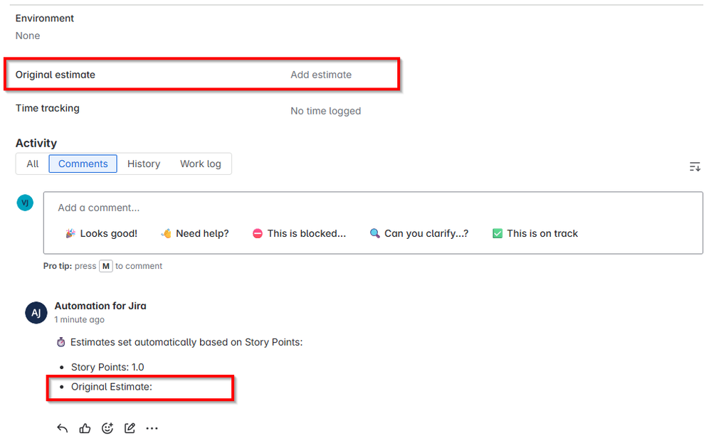

The rule gets triggered as expected (comment gets added on the work item - without the converted value; audit log shows a success)
Original Estimate field remains unchanged.
This is the smart value rule:
customfield 10053 is Story Points (tried 'issue.Story Points' which also does the same)
{{#if(equals(issue.customfield_10053, 0.5))}}2h{{/}}
{{#elseif(equals(issue.customfield_10053, 1))}}4h{{/}} {{#elseif(equals(issue.customfield_10053, 1.5))}}8h{{/}} {{#elseif(equals(issue.customfield_10053, 2))}}8h{{/}} {{#elseif(equals(issue.customfield_10053, 2.5))}}12h{{/}} {{#elseif(equals(issue.customfield_10053, 3))}}12h{{/}} {{#elseif(equals(issue.customfield_10053, 3.5))}}16h{{/}} {{#elseif(equals(issue.customfield_10053, 4))}}16h{{/}} {{#elseif(equals(issue.customfield_10053, 4.5))}}16h{{/}} {{#elseif(equals(issue.customfield_10053, 5))}}16h{{/}} {{#elseif(equals(issue.customfield_10053, 5.5))}}24h{{/}} {{#elseif(equals(issue.customfield_10053, 6))}}24h{{/}} {{#elseif(equals(issue.customfield_10053, 6.5))}}24h{{/}} {{#elseif(equals(issue.customfield_10053, 7))}}24h{{/}} {{#elseif(equals(issue.customfield_10053, 7.5))}}24h{{/}} {{#elseif(equals(issue.customfield_10053, 8))}}32h{{/}} {{#elseif(equals(issue.customfield_10053, 8.5))}}32h{{/}} {{#elseif(equals(issue.customfield_10053, 9))}}40h{{/}} {{#elseif(equals(issue.customfield_10053, 9.5))}}40h{{/}} {{#elseif(equals(issue.customfield_10053, 10))}}40h{{/}} {{#elseif(equals(issue.customfield_10053, 10.5))}}40h{{/}} {{#elseif(equals(issue.customfield_10053, 11))}}48h{{/}} {{#elseif(equals(issue.customfield_10053, 11.5))}}48h{{/}} {{#elseif(equals(issue.customfield_10053, 12))}}48h{{/}} {{#elseif(equals(issue.customfield_10053, 12.5))}}48h{{/}} {{#elseif(equals(issue.customfield_10053, 13))}}48h{{/}} {{#elseif(equals(issue.customfield_10053, 13.5))}}48h{{/}}

I appreciate your clarity. Initially, I did have them as separate If statements like:
{{#if(equals(issue.customfield_10053, 1))}}4h{{/}}... and so on
However, this did not work either (same behavior - log says "success" but nothing happened) which is why I asked OpenAI for suggestions to improve it.
