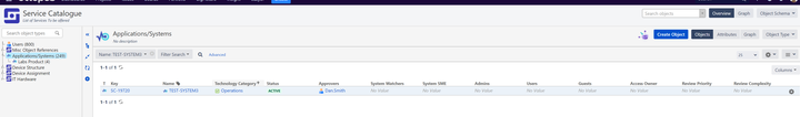

We are using Insight in our Jira Server instance to manage our enterprise applications. For each system (object) we've defined three separate object attributes (Guests, Users, Admins) that captures all users that have access to the system.
What we are trying to achieve is adding users to these Insight attributes when a Jira ticket is updated:
We've managed to leverage the script from the Insight docs - Update Object attribute
However naturally it is updating/overwriting any existing users captured in the Guests/Admins/Users object attribute. We want to add the user so we can get an accurate list of users for our systems.
Does anyone out there have any experience of what we are trying to achieve? How did you manage to ADD a user to existing object attributes without deleting what already exists in the object attributes field? Any script advice much appreciated!
Thank you!!
