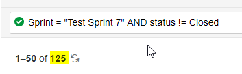

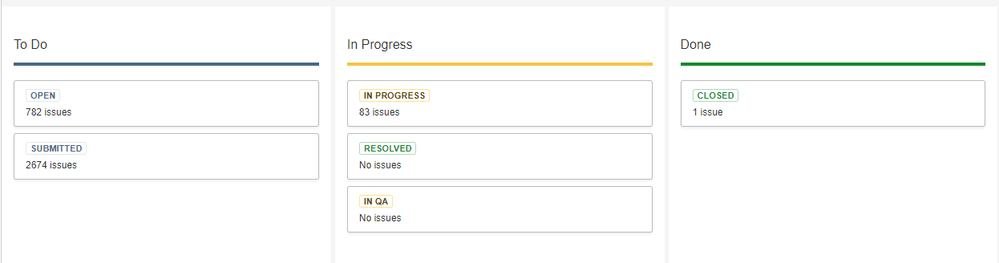

After completing a Sprint the Resolved & IN QA are not moved into the next sprint and those issues are not yet done so we manually move it to the next sprint but it will affect the burndown since it's a scope change. I also checked the Column management in the board configuration and it shows No issues are on "RESOLVED" and "IN QA" status (Screenshot #3)

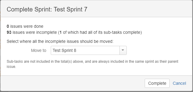

Please refer to the attached photos, The number of undone issues are 125 (IN PROGRESS, RESOLVED, IN QA) (Screenshot #1) and it should be shown on the incomplete issues that will be moved to the next sprint but there are only 93 issues (OPEN, SUBMITTED) that are shown to be moved to the next sprint (Screenshot #2).

Usually, this problem happens when the resolution of some issues is configured with a value, so the system considers it as closed. I really believe that the resolved status is with a valid resolution, so this might be the root cause.
Please, perform the following steps to identify the issues that are not moving to the next Sprint:
- Add the parameter resolution = unresolved to your JQL query and check if the number of issues changed.
- Filter your JQL in a per-status base in order to identify which issues are being considered closed and find a pattern between it (Common Status, common resolution, etc), so we can better understand the root cause of the problem. Try the following query and then remove the statuses one-by-one so we can identify which issues are being considered closed:
Sprint = "test Sprint 7" and status in ("In progress", Resolved, "In QA") Resolution = unresolved
