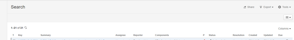

Hello,
We experience several problems with the filters in Jira 6.3.1. When we open some filter the filter field is missing. Also we are not able to save a new filter.
The end points
/rest/api/2/filter/favourite?expand=subscriptions[-5:]&_=1533276806440
/rest/api/2/filter/29509?expand=subscriptions[-5:]&_=1533276806673
return 400 without response body. On the server side there are not any errors.
This is the screenshot with the problem:
Could you advise how to fix the issue?
Thank you,
Slavka Petrova

Hello,
After the investigation we have found that the issue appears because of new Tomcat version :
The new behavior of Tomcat is an intentional fix for https://bz.apache.org/bugzilla/show_bug.cgi?id=62273 . With this they make Tomcat completely compliant with RFC7230 (https://tools.ietf.org/html/rfc7230) – The HTTP 1.1 spec and RFC3986 (https://tools.ietf.org/html/rfc3986) – the URL syntax spec. Previously Tomcat had some of the requirements of these specifications relaxed.
 With the new change Tomcat expects all of the characters, which should be url-encoded according to the specifications, actually to be url-encoded.
Question now is if there the JIRA version where such Tomcat behavior  is fixed?

In the tomcat configuration for the connector, there should be support for a relaxedQueryChars configuration option, as described here http://tomcat.apache.org/tomcat-8.5-doc/config/http.html#Standard_Implementation that you can add.
Originating from this issue (which I found from your link: https://bz.apache.org/bugzilla/show_bug.cgi?id=62273#c20 )
Andreas Stenius
September 28, 2018
Workaround detailed in the jira ticket: https://jira.atlassian.com/browse/JRASERVER-67974
