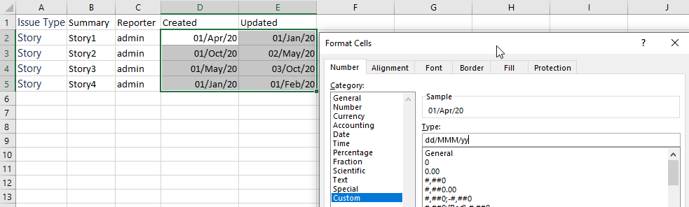

I installed fresh 8.13.17 and created a test project.
I took your latest sample you sent and simplified it to avoid having to map couple more things - but I kept the dates as is:

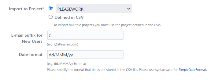

Specifying 'dd/MMM/yy' format, and saving it:
Then I went to External System Import - CSV, and selected my project with the date format:

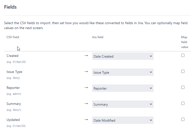

Next, I selected the field mapping:
And hit next.
