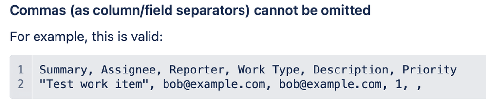

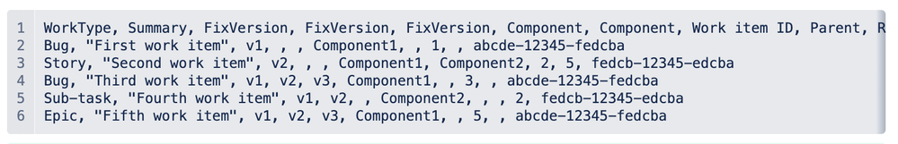

Oleksii Melnyk _MOY Apps_
July 8, 2025
Nice, in this case, try to rename Issue type to "WorkType" or "Work Type".
I think @Kai Becker sent a relevant link for your case:
https://support.atlassian.com/jira-cloud-administration/docs/import-data-from-a-csv-file/
Снимок экрана 2025-07-08 в 14.28.06.pngСнимок экрана 2025-07-08 в 14.28.40.png
