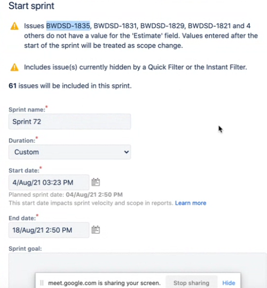

paulsnedden
August 3, 2021
Looks like it's our turn to suffer from this. One of my teams in India can't start their most-recent sprint as there's a bunch of issues from another squad that are related to it......there's been zero changes to both projects filter queries in more than a year.
