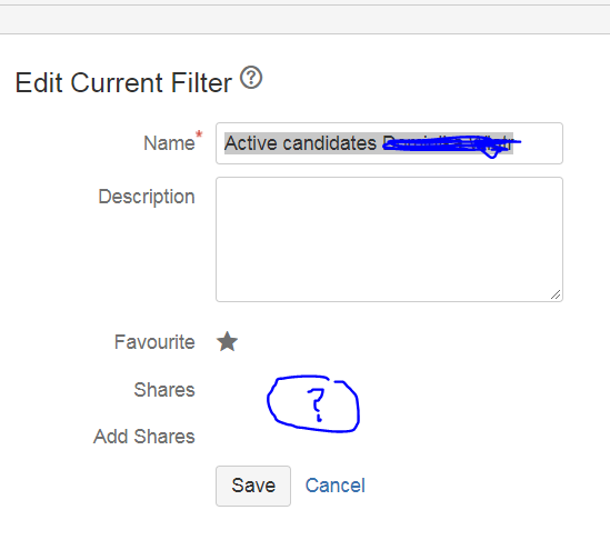

HI,
I can't share filters, my team mates too. I have enabled popups and it didn't help. It was working few days ago. Any ideas?

Hi @Urszula Forenc,
Has anything changed to the Global Permission Create Shared Objects?
https://confluence.atlassian.com/adminjiraserver071/managing-global-permissions-802592439.html here is a link to the documentation on Global permissions.
Hope this helps

Hi, thank you for your answer. Global permissions are ok and didn't change.

Hi @Urszula Forenc,
Could you check that all users listed within the  jira-administrators group also within the jira-users group?

They are...

From what you have described it seems to be Bug.
Here is what Tim LaMarce implemented as a work-around:
Have another non-admin user create a basic search. Have them share it. Log in with your admin account, go to the list of shared objects, find their filter, and take ownership. Now you can edit it and do whatever else you want.
https://confluence.atlassian.com/adminjiraserver071/managing-shared-filters-802593150.html
Here is the link to the Bug, though it does note Dashboards it is worth a shot.
Are you able to try this?

Well, I am an admin :) and I didnt remove it.

@Urszula Forenc , Are you removed from the group that is given the global permission of 'Create shared objects'?
Do you find options to share a dashboard?
Urszula Forenc
April 9, 2018
Hi, no I am not removed. I can share dahboards... only filters have issue.
