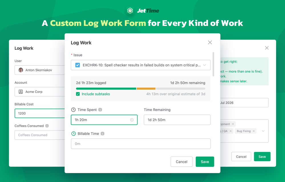

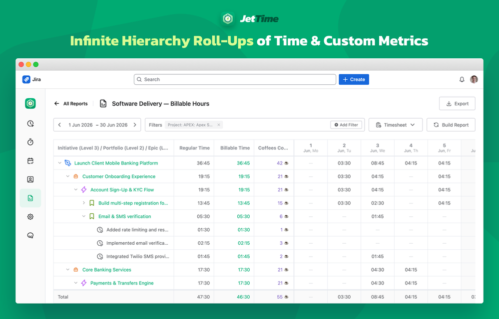

Native Jira only rolls time up one level — a Sub-task into its direct parent, and that's where it stops. Nothing carries the hours further up through StoryEpicMilestone, so the higher you look, the emptier it gets.
That full multi-level roll-up is exactly what JetTime (a third-party Jira app) does. It's a reporting layer over your existing Jira work logs — it reads the hours already logged and totals them at whatever level you pick, at any depth. And since Milestone sits above Epic as a custom level, JetTime picks that up too — so the hours reach all the way to Milestone, not just Epic.
  • Every tier is its own grouping dimension — Story, Epic, Milestone, and anything above — a total at each, not just one
  • All projects in a single report
  • Custom fields and metrics roll up the same way — cost, billable hours, mileage, whatever you track
  • Filter by user, date, or account; export to Excel or PDF
One more thing that fits your hierarchy directly, and it's something we haven't seen any other Jira time tracker do: you can turn logging off on the aggregation levels. Set the Log Work form by rule so people log only on real work — Sub-task and Story level — while Epic and Milestone stay pure aggregation. No one logs straight onto them, so nothing gets double-counted and the rolled-up totals stay clean.
One honest note on your first point: JetTime rolls the hours up inside its own reports — it doesn't rewrite Jira's Original Estimate field. Trudy's automation is the route if you need that native field populated; JetTime is the route if you just want to see the rolled-up time per level, without touching your data.
👉 JetTime on the Atlassian Marketplace
— Anton, JetTime founder

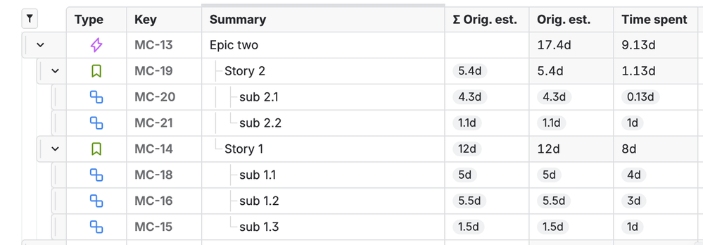

Hey @Shivoy Malhotra ,
I see, in the current version of JXL, it would be possible to roll the values up (to any level) via a custom formula column. E.g. a `JFL script` like the one below would give you the sum of the originial estimates on any level in hours.
const walk = (item: WorkItem): number => {
return SUM(
item.originalEstimate ?? 0,
...item.hierarchy.children.map(walk)
const summedUpOriginalEsitmates = walk(this);
// original estimates are stored as seconds in jira, so we want to convert it to hours
return summedUpOriginalEsitmates / 3600;
This works, but I would only consider this as an intermediate workaround.
Good news though is, that we are currently in the process of adding another option to our structure levels - `Hierarchy and sum-up`, which will allow you to roll-up also these values in your hierarchy definition, without any intermediate sum-up row.
Once shipped, it will look like this:
In the screenshot above, you see the `original estimate` and `time spent` values rolled up, the roll up style will be configurable as well, among other things.
I cannot give an exact ETA, but I'd expect it to be shipped soon-ish 🤞.
Cheers, Paul
