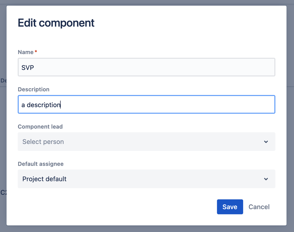

Hi David,
Thanks for your answer. While it is possible to set multiple components, in this project we want to indeed copy the first value. A quick test does appear that your code above works for me. Whats the different between name and description here?
Hi Steven,
the "name" field is the component name, while the "description" field is the component description, as defined in Jira:
