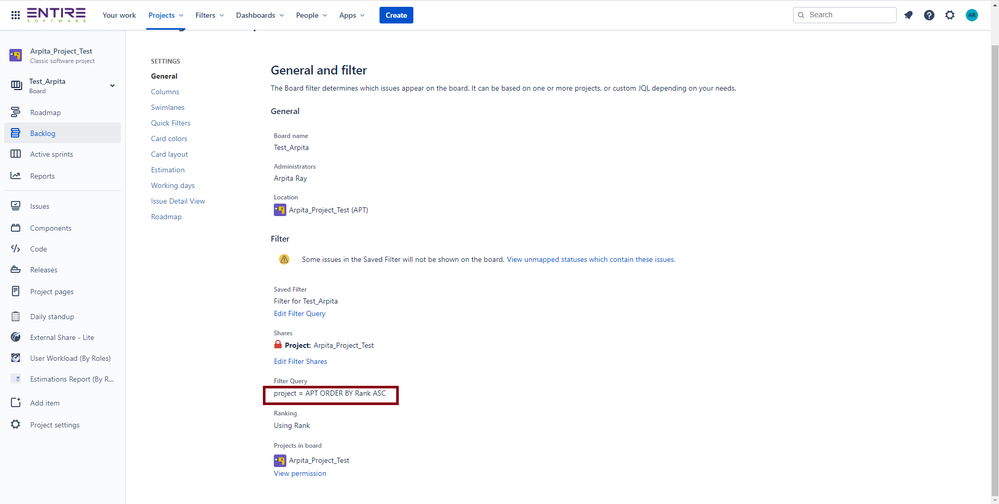

1. Go to board settings --> General
2. check filter or edit as below
project = "project Name" ORDER BY Rank ASC

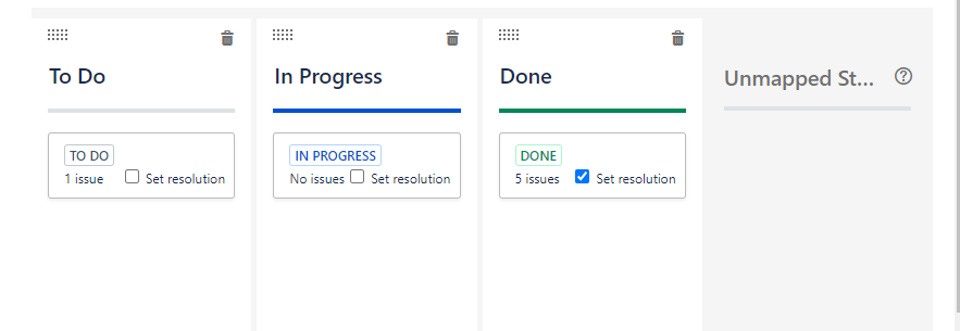

image.pngAnd tag all your workflows statuses as above .
To Do || In Progress || Done these are columns
To Do ( 1 Issue) || IN PROGRESS (No issues) || Done (5 issues) are workflow statuses.
Please check and let me know

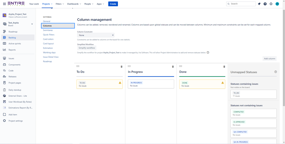

@KAGITHALA BABU ANVESH - Thank you for the quick response.

Hi Arpita,
Drag and Drop the "Unmapped Statuses" in to Columns.
Under 1. To Do --> TO_DO
2. In Progress --> QA COMPLETED, QA IN-PROGRESS (Like this blue colored)
3. Done --> COMPLETED , IS APPROVED
Deleted user
December 23, 2020
@KAGITHALA BABU ANVESH - It worked like a charm!! :) Thank you so much.
