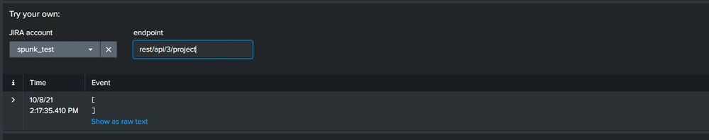

I've have an empty answer:

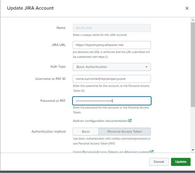

But from Splunk side I think everything is fine:
Obviously I've changed the actual values but, as I mentioned before, via curl it does work :(

I took a closer look at the configuration documentation over in https://ta-jira-service-desk-simple-addon.readthedocs.io/en/latest/configuration.html and it appears that you've selected the "Personal Access Token" option in the authentication method.  This is actually incorrect for a Jira Cloud site.  Try switching this to use the Basic authentication in that page, while still using your REST API token here.
Part of the confusion here might be the term 'Personal Access Token'.  Atlassian has only ever used that precise term in regard to Jira Server/Data Center versions 8.14 and higher which have provided end users to create their own tokens (older versions on this platform do not have this feature natively).   Whereas in our Cloud platform, these are referred to simply as "API tokens".  I suspect this app is trying to manage both platforms which can leverage these different tokens in slightly different ways to make these calls.
