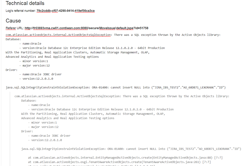

Dear Team,
We are getting the attached error while trying to performing move option in jira issue.
Kindly help. Thanks in advance.

My first thought on reading the error is that there might be some corrupted data in the database, having a NULL where it is expected to have a value and it's colliding with a table constraint.
After a quick research, I read that empty strings are treated as a NULL value by Oracle DBMS, so that might have something to do with the error.
There's a KB article on how to fix a quite similar error here:
https://confluence.atlassian.com/jirakb/ora-01400-error-when-deleting-an-issue-720639157.html
Also have a look at:
https://jira.atlassian.com/browse/JRASERVER-61007
specially the part about database drivers.
Anyway, the research on this particular issue probably needs a deep research, diving into your logs.
I'd suggest opening a ticket with Atlassian Support describing how to reproduce the issue, attaching to the ticket a screenshot of the error and a Support ZIP file.
