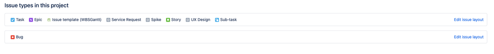

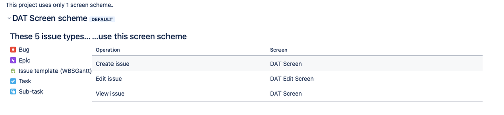

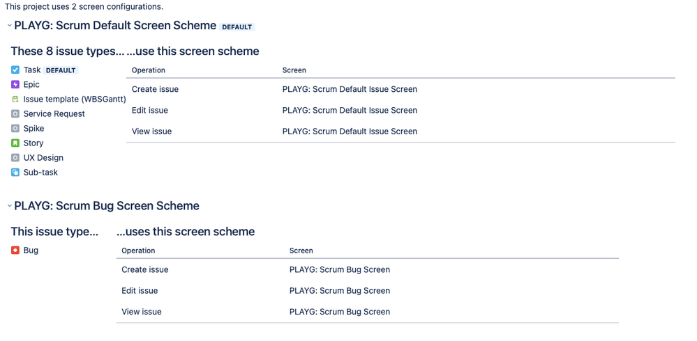

The only difference I can see between the project in which this works and the project in which it doesn't is that:
- In the first project (in which it works) the screens use only one screen configuration
Screenshot 2025-05-21 at 18.19.21.png- In the second project (in which it doesn't work) the screens use two screen configurations, on each for issues of type bug and the other of the rest of the types. Both screen configuration have the time tracking field showing in the layout.

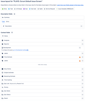

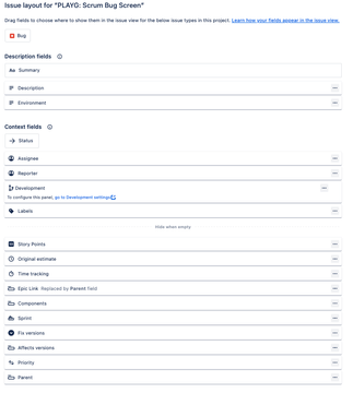

I'm adding screenshots of the screen layouts just in case they help:
Screenshot 2025-05-22 at 09.44.44.pngScreenshot 2025-05-22 at 09.45.42.pngScreenshot 2025-05-22 at 09.46.11.png

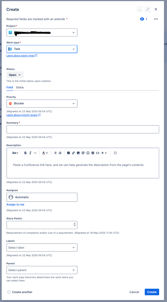

I found another difference between the two projects.
In the not-working project, although the Original Estimate field is configured in the edit and and view screens, which according to the screen scheme are the same as the create view, when I try to create an issue directly in Jira, the field doesn't appear. (I'm attaching a screenshot of the create view)
Is it possible that the screen has the field and the layout also, but the create view is showing something different?
Philipp Sendek
May 22, 2025
Hi @Sara Bardaji ,
thanks for the additional info. That sounds quite tricky and is hard to remote-troubleshoot. But when you say that the screen scheme config should cause the create screen to also have the field and it's not there, I would simply assign the correct screen to the create operations in the screen scheme.
Maybe something is off with the configuration and redoing the configuration or doing a direct mapping can help fix that.
Other than that, having ruled out everything else I can think of, I would usually move on to change configurations back and forth (remove field from screen and re-add it, remove field from layout and re-add it, etc.)
P.S.: Regarding your question on permissions: Yes, if you are allowed to adjust the field in the UI, your permissions are fine.
