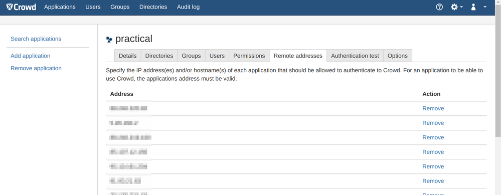

Have you tried adding Jira's IP address to the remote address' section of your Crowd.
Like this:
Selection_019.pngAlso check out this document, it gives the solution of your error:
https://confluence.atlassian.com/jirakb/connecting-jira-to-crowd-throwing-applicationpermissionexception-301662474.html
