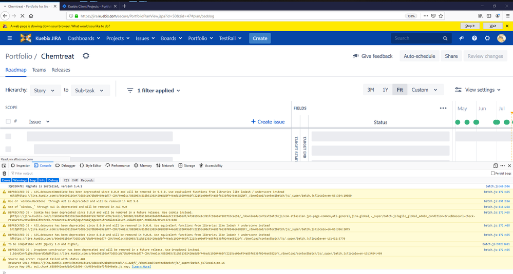

A few days ago, the Product Manager was able to see a  Portfolio Plan and prioritize the stories in it.  Today, when they go to open the plan, it hangs.  Other plans seem to load ok, but there is something funky with this particular plan and I can't navigate to Configuration on it to see if it's a problem with the query or the filter or anything.
If I look at the Console on the page, it complains about a Source map error (failed status 404)
Browser: Firefox

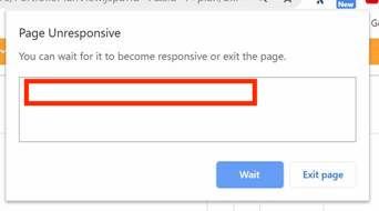

I'm currently having the same problem using Google Chrome as my browser.  At first I thought it was a "trying to connect to too many projects" error but I have verified my queries are within the necessary limits.
Here is what's going on:
When I attempt to load my Portfolio Plan the page begins to load and the column where the issues should be displayed has blank with color rolling rectangles displayed.  When I hover over the rectangles a message popups saying, "Loading Issues...".  This occurs for 5+ minutes then the rectangles disappear and the columns where issues should appear are empty.

The issue is, is the browser just freezes. This is something that occurs in all of the users, trying to access this.
Their current Jira Server is; v7.13.5 and their Portfolio for Jira version is 3.6.0.
Right now, i'm trying to record for the HAR files, but again they are not recording this, as the page has frozen, just a blank screen.

Thanks for the details and this is odd and defiantly looks like you're hitting some buggy behavior on that plan.  I have not seen that error before I have done a bit of searching and I'm not finding anything specific on that error so we will need to narrow this down with some troubleshooting.
First off, you noted that you are seeing this on Firefox, is this occuring on alternate browser types as well or is is specific to Firefox only?  Also Just to rule out anything that might be locally occuring in the browser check out our "Browser Troubleshooting Guide" for a few additional items to check.
You also noted not being able to navigate to the plan settings to check the issue sources for problems in the filters, can you try using the Direct URL to get to the settings, with this format to take a look at what projects are bing associated via the connected board filters:
https://BASE_URL/secure/PortfolioPlanView.jspa?id=50&sid=47#settings/scheduling
If you are able to get to the setting with the direct URL check the issue sources for the plan and let me know the full filters used by any of the linked boards.
If you cannot get the issue sources from the UI on the front end the data is stored in the database in the table "AO_D9132D_ISSUE_SOURCE", from your screenshot the plan ID is 50 so you could use the following Query to get the issue source data (Noting format is for PSQL so adjust accordingly for your db type):
SELECT * FROM "AO_D9132D_ISSUE_SOURCE" WHERE "PLAN_ID" = 50;
Look at the "SOURCE_VALUE" column and this query will give you rapid view id for any linked boards and the project ID for any linked projects.  To get to the board associated with the noted rapid view ID go to BASE_URL/secure/RapidBoard.jspa?rapidView=Insert_Rapid_View_ID_here, and again pull the filters so we can take a look to see if anything is odd in the filters.
Also can you check the logging for any errors triggered when you load the plan that could help narrow this down further.
