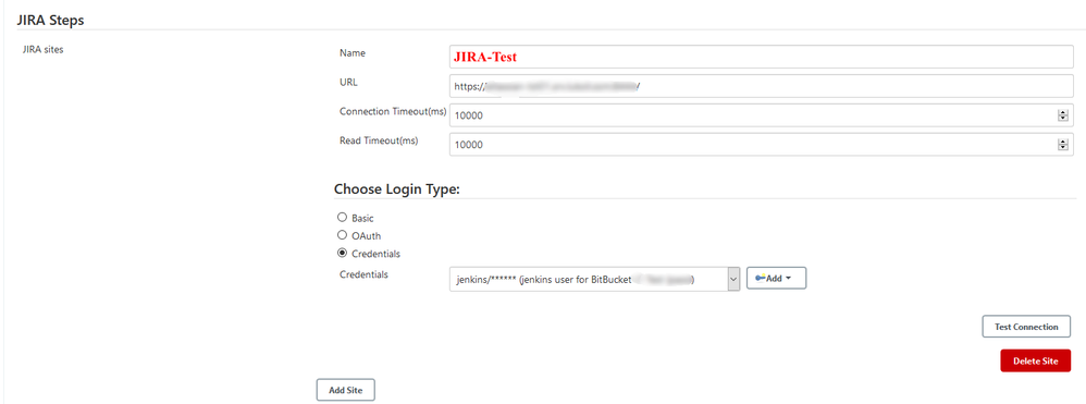

If the problem is still relevant, try using the following script in Jenkinspipeline to contact JIRA and make comment to Issue TSP-26:
script {
withEnv(['JIRA_SITE=JIRA-Test']) {
def comment = [ body: 'Test comment from Jenkins' ]
jiraAddComment idOrKey: 'TSP-26', input: comment
where JIRA_SITE=JIRA-Test is predefined Jira site in Jenkins system settings:
