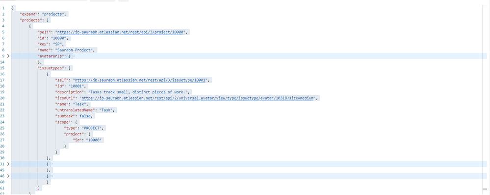

Also, When i am using that endpoint for the jira cloud , It is working fine
Url used: https://{host}/rest/api/3/issue/createmeta
Response :
