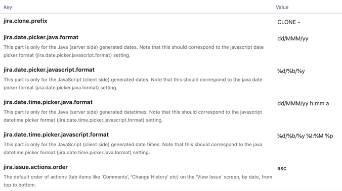

Hi,
It seems like the end date picker for my sprints isn't working - no matter how I put in the information, even if it's in the format that is suggested, I get a message saying that it's not a valid format.

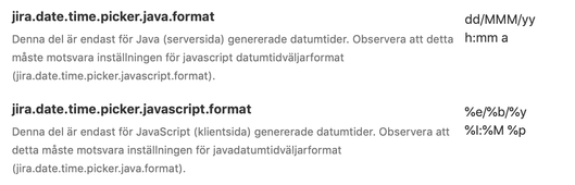

I've read previous posts suggesting to go into advanced settings and making sure that the java and javascript date picker formats are the same. It looks like this:
Is this correct? I tried changing it so that they are the same, but then when I click the "Start sprint button", it just keeps loading and nothing happens, so I changed it back to how it was.
What else should I try?

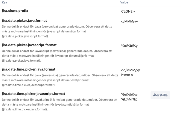

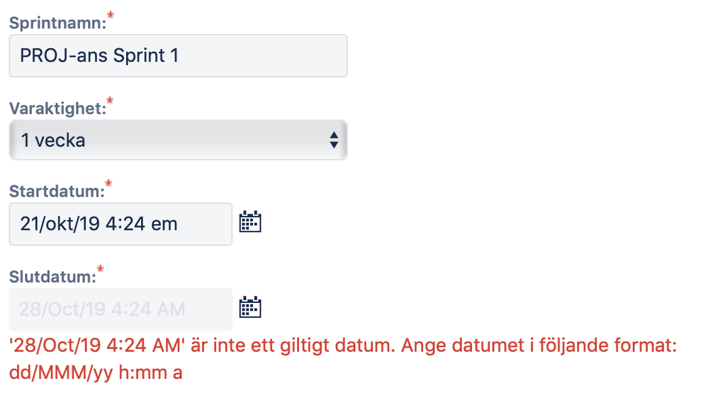

Matilda Westerdahl
October 21, 2019
Still not working :(

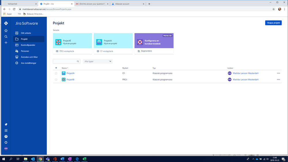

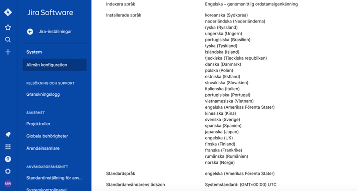

Matilda Westerdahl
October 22, 2019
Hi,
It seems indeed that there is something wrong here. It says in the settings that the default language is set to English, but everything is still in Swedish. It flimmers and shows in English for one second and then switches back?

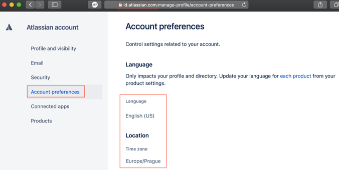

Pavel Junek
October 22, 2019
Hi,
Thanks for the screenshot. The problem with your Swedish settings will still be with your profile. Please try to change to English:
Click Your profile -> Account settings -> Account preferences
Pavel

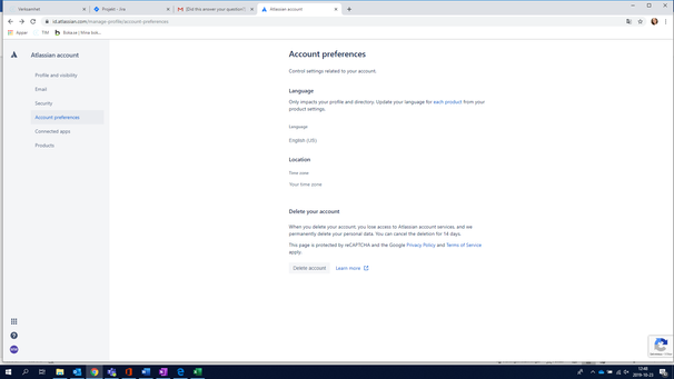

Matilda Westerdahl
October 23, 2019
Yes, this one is set to English, and everything in that view is in English... But when I go to back to Jira and the projects it's still in Swedish.

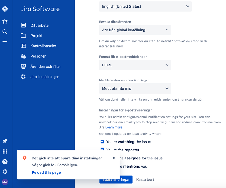

Matilda Westerdahl
October 23, 2019
I went to check my personal settings and here I see it's set to Swedish. But when I tried to change it to English it wouldn't let me save the changes, I get a message saying that something went wrong:

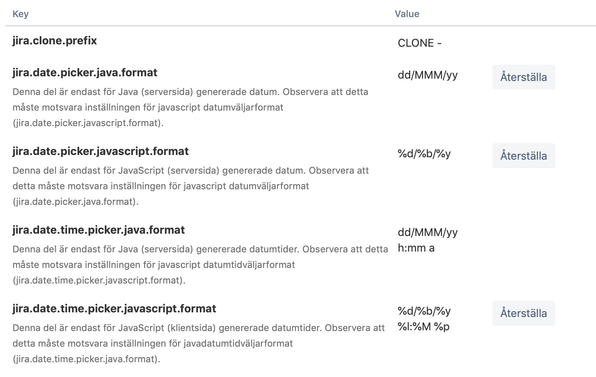

Matilda Westerdahl
October 21, 2019
Hi Pavel,
I followed your suggestions and it looks like this now (in Swedish but I think you understand anyway)
.... But I still have the same problem:
Pavel Junek
October 21, 2019
Hi @Matilda Westerdahl,
Looks like you still don't have the date format setting correctly. Please try adjusting the settings as follows:
Pavel

October 20, 2019
To change the date you need to know the following:
In your case:
  • dd/MMM/yy h:mm a   means 05/Jun/19 8:50 AM
  • javascript.format have to be   %d/%b/%y  %l:%M %p
Kind Regards
Pavel
Matilda Westerdahl
October 20, 2019
Hi Pavel!
Thanks for the reply. I have entered the javascript format like you said, but it doesn't seem to make any difference. Could it have to do something with the fact that I'm using it in Swedish (different time zones)?

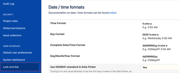

Your welcome!
Please try to check Jira's settings -> Look and feel.
Pavel

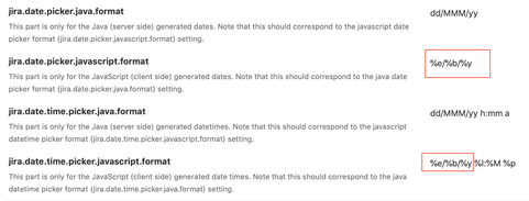

Pavel Junek
October 20, 2019
And you have to make the same settings for jira.date.picker.javascript.format and jira.date.time.picker.javascript.format - new format:
  • jira.date.picker.javascript.format: %d/%b/%y
  • jira.date.time.picker.javascript.format: %d/%b/%y  %l:%M %p
