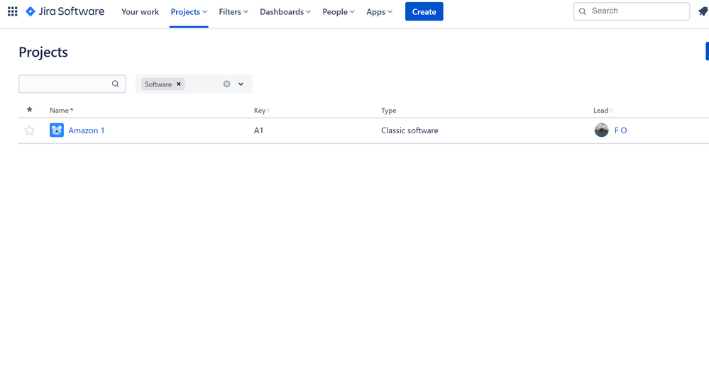

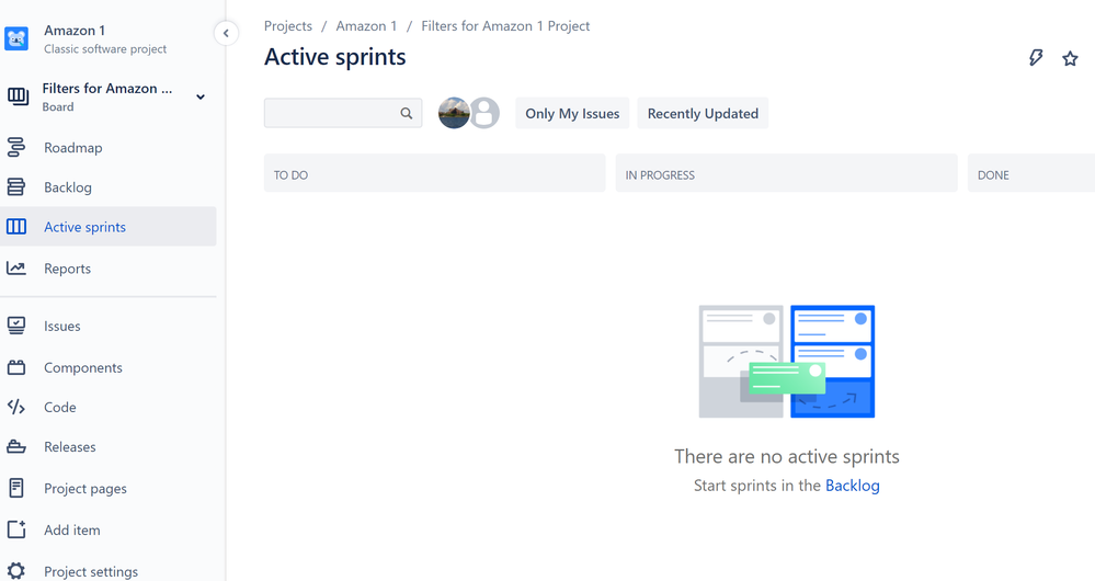

This what I get when I try to go to my project and see my backlog (with my issues included of course). But I find myself in the new board I created which already has the new filters. Simply put, how do I remove or edit the filters in my default project board. Going to board settings and general has not helped.
Jack Brickey
March 2, 2021
I do not understand the purpose of the first two images. I guess it is how you are navigating but that isn't really important here.
In the last image....
  • You are currently viewing the "Active sprints" page. If you want the backlog then click on the "Backlog" in sidebar.
  • Just under "Amazon 1 Classic software project"  you see "Filters for Amazon ... Board". You will see a down arrow that can be clicked to expose all boards associated with the current Amazon 1 project.

FO
March 2, 2021
Hi Jack, many thanks again. So I followed your first 2 steps; clicked on backlog (which I had repeatedly done previously with an empty backlog displaying) and then I selected the Amazon 1 project and found the board I was looking for. I am surprised because I had been going from the Jira homepage to the Amazon project, then to the backlog but ending up with the filter board for Amazon 1. I think I need a coffee but many thanks Jack!!! :)
FO
March 2, 2021
My bad, navigation was definitely the problem; I was searching for the Project Amazon board meanwhile I was within the "Filters for Project A board."
