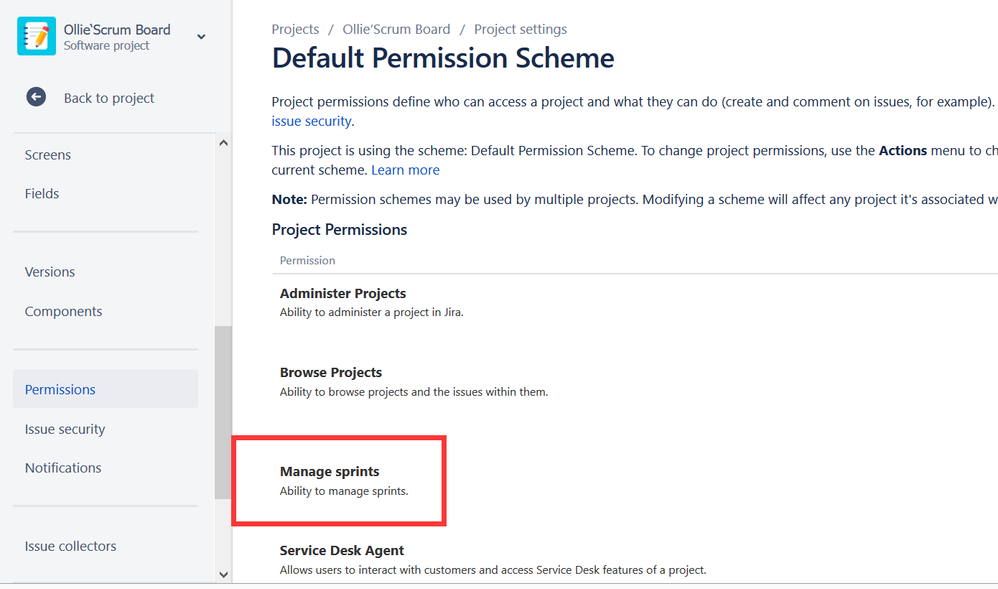

Im also having issues deleting a sprint. My test user has product access to
- Jira Software
- Has access to the project
- Has 'Manage Sprint' permission through a Adminstrator role
- Also has the Adminstrator role assigned to the Manage Sprint permission on the Permission Scheme that this project uses.
Still can't delete a sprint. I see the comments above saying you can't delete an active sprint but as an admin I seem to be able to?

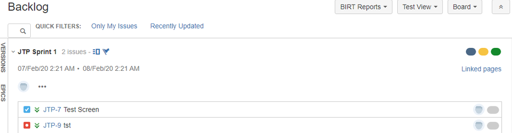

Hi Stephen,
I followed your steps but am not find exact option Delete Sprint.
Hi Stephen,
Before start of the sprint i can able to see the Delete Sprint button on the cog icon ( 3 dots ).
After started the sprint i cannot able to see Delete sprint button.
I think for this version of Jira software server 7.3.1 this feature is not available.
Let me share your Thoughts!!
Please find attached screenshot for your understanding.
Hi @Roja Gurram
You can't delete an active sprint - you'd need to complete the sprint first (from the active sprint board) then you can delete it.
Ste
Ok thanks for that.
Previous i have shared screenshot's also after closing the issue though i wouldn't have get an Delete option. I thought am going in wrong direction.
Can you please show/send me one Example for your above suggestion in Jira server.

Hi @Defny ,
As @Ste Wright said, you can try the steps he mentioned.
If you have sprint management rights, but still cannot delete sprints, please check whether your scrum board contains Issues for multiple projects.
If you have the above situation, you need to have management sprint permissions for multiple projects at the same time before you can delete them.
