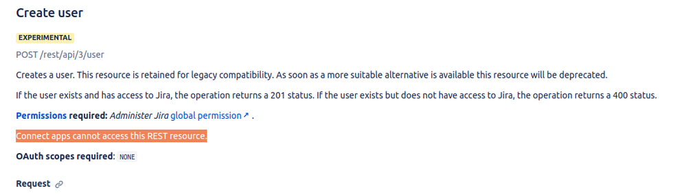

Hi All,
I have cross-check the Rest API and found the API can't accessible from connected Apps. Is there any way to create the user. I have setup OAuth 2.0 (3LO)

Ivan Lima
March 24, 2022
Are you trying to use Atlassian connect/Forge? To my knowledge, you can't use OAuth (3LO) to create users. In this case, you need to use basic auth (email + api_token). Have a look at how Atlassian handles user provisioning via API.
