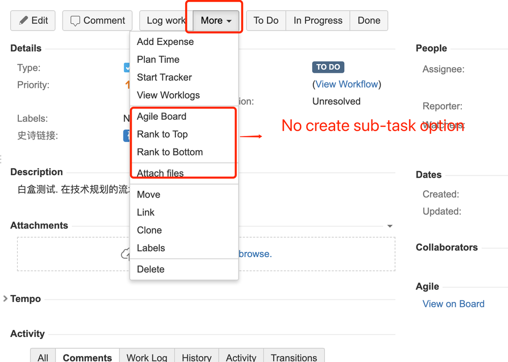

Unable to create subtasks for all issue types (Epic/Story/Task)
I tried the Field Configurations and Screen Configurations but didn't find a place to configure it.
How can I enable or restore this feature back?

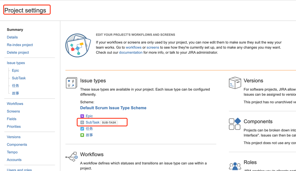

I checked Project settings .The subtask issue type exists in the issue type scheme associated with the project (as shown in the screenshot below)

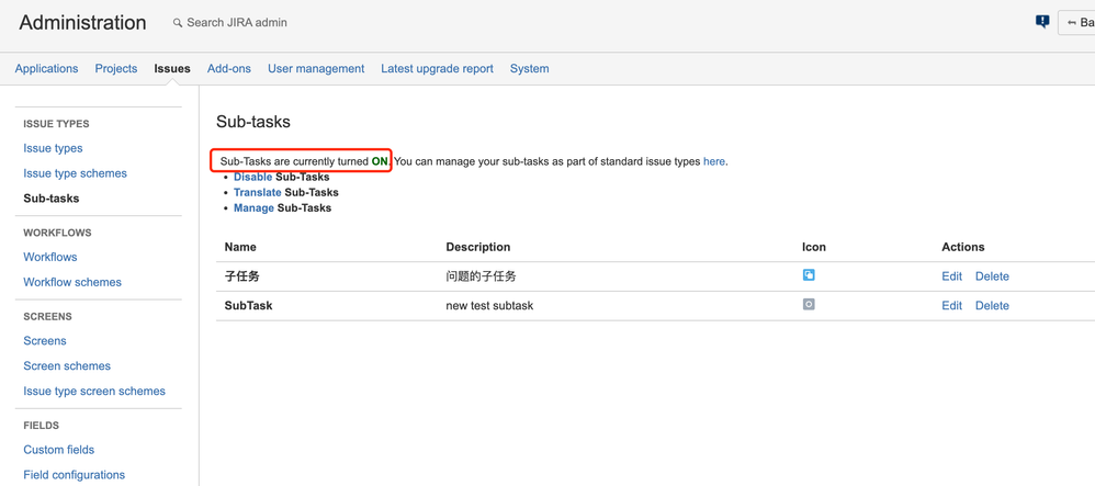

看上去你并没有使用系统默认的Sub-task,而是自己创建了一个新的IssueType,可以做一些尝试:
1.Issue Type Scheme里把原来的Sub-task加入,是否可以创建?
2.Workflow里哪一类工作流关联到了你的Subtask?
3.其它Project也无法创建子任务吗?还是仅仅这一个特定的Project?

最后发现是插件被人禁用了的原因,把相关插件启用就出来了. 操作方法如下:
管理>插件>插件管理>选"系统">问题操作插件>查看问题 Ops 栏创建的子任务链接 (create-subtask)
选择启用

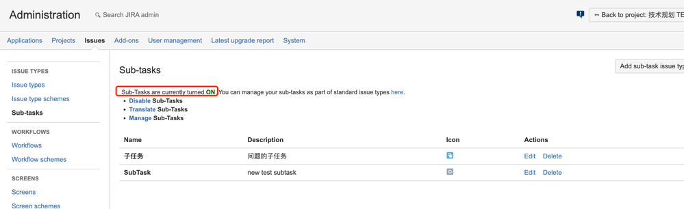

Fengjie
June 30, 2022
Hi @Florian PEREZ _Valiantys Administrator_
Thanks for detail page for enable sub-task.
I checked  Sub-tasks are enabled in the Sub-Tasks administration page(screenshot below))
