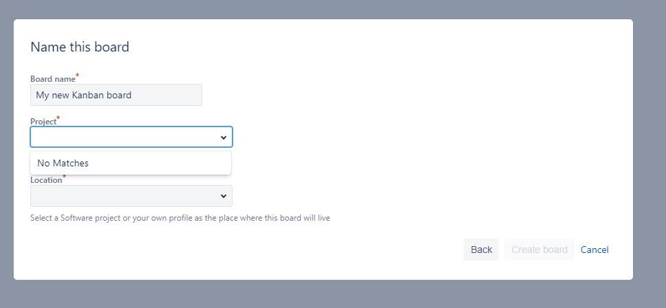

I have created a project, with a scrum board and we are happily adding our epics and stories, etc. At this point we need to add a kanban board to the project.
When I go to the create board option and select kanban board from existing project the dropdown to select the projec stays empty or when I type a letter says "no matches".  The "Create Board" button stays disabled.

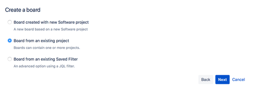

What I understand here is that you are getting started with JIRA Cloud and based on the description, you have created 1 project assigned to the Scrum board and you would like to create a Kanban board from here. For example:

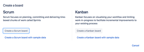

Creating the board

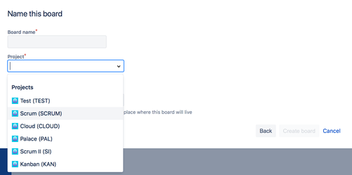

Choosing an existing project
From the dropdown list, I choose the project SCRUM which was originally created with the Scrum template

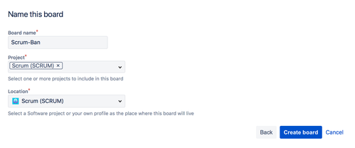

Fill in the details as we can see below

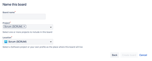

Can you please confirm if you defined a name for this board when you are at the final screen as that could be one of the reasons why the Create board button is disabled? For example:

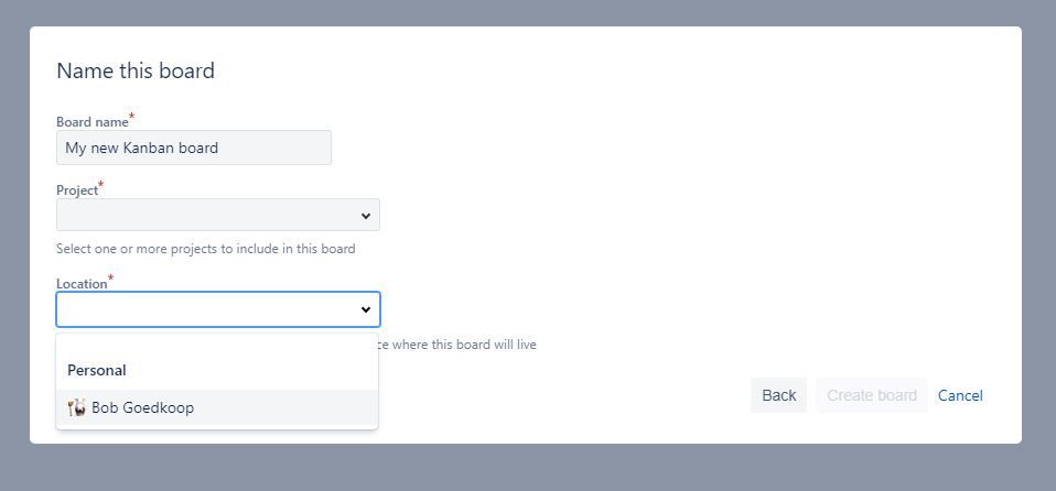

Thank you for your answer. With searching through thye community the steps you provide are exactly what I tried to do. I get stuck at the point that when selecting the current project to assign the new kanban board to stays empty (see screenshot below), same goes for the location (see screenshot below).

I had another issue, adding time tracking/logging to the items. And as it turned out this was not possible in a next-gen project (what it is that I had) but was possible in a classic project.
I created a new classic kanban project, moved my items there and ...  this issue was no longer an issue.
