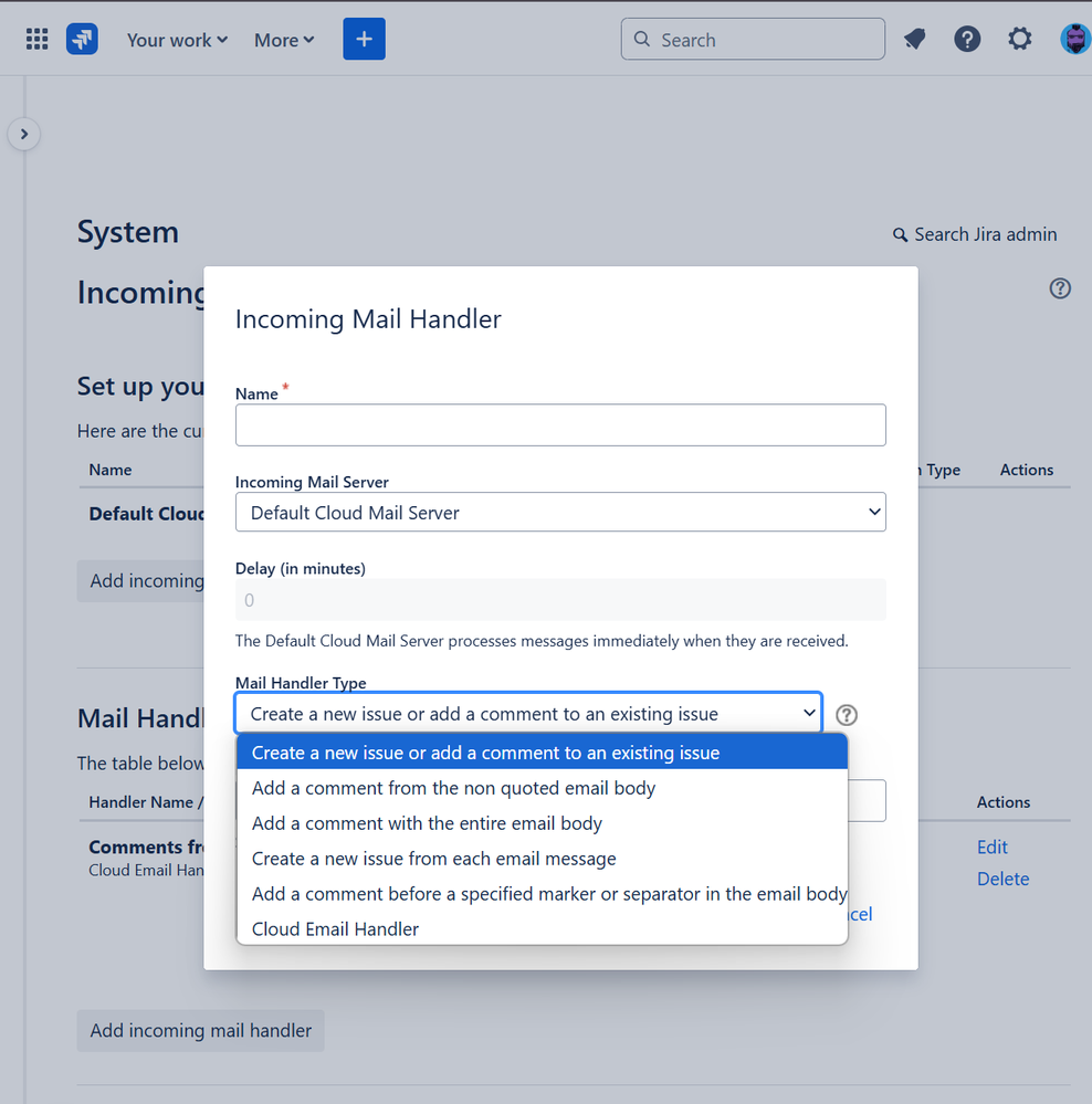

Hmm, check again the configuration of the incoming email handler

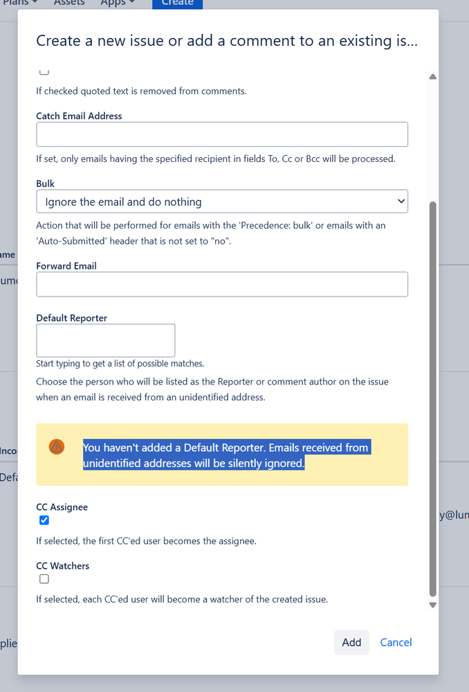

then check if the Rerporter is set and if that reporter can create issues in given project:
If that is not the case, then you can check if emails from different email adress are not processed. Maybe the email which you are testing is marked/considered spam
